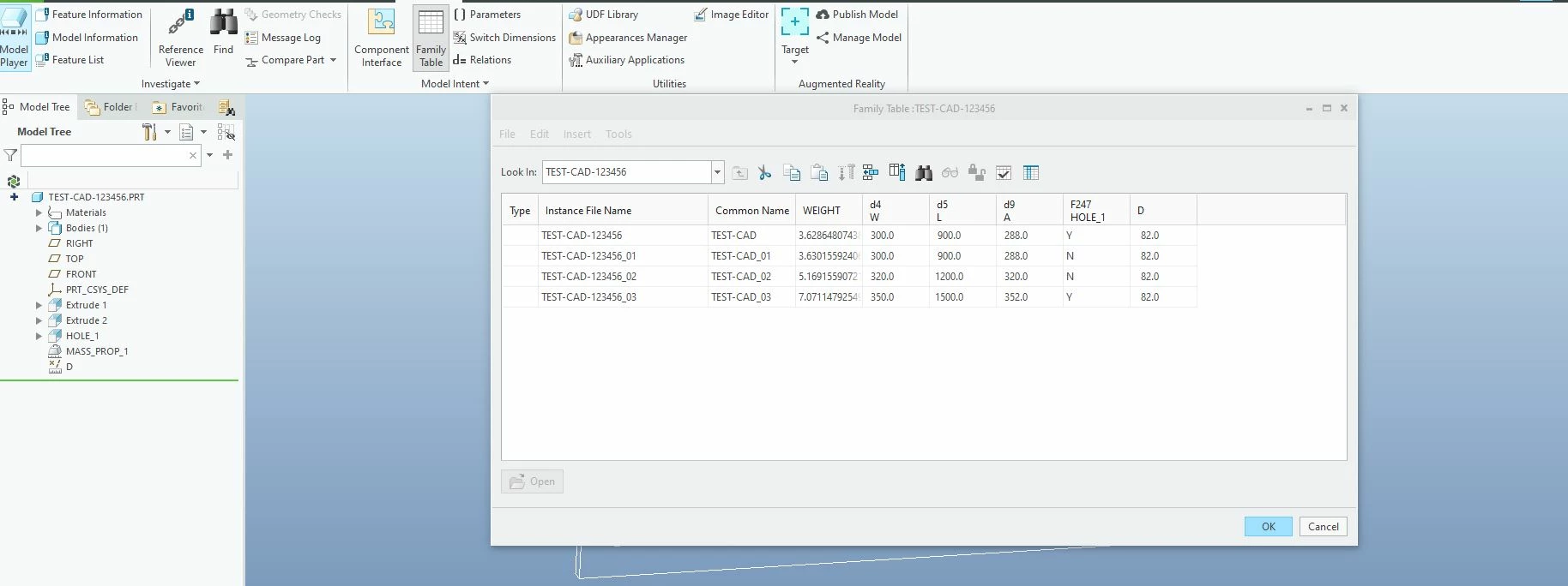

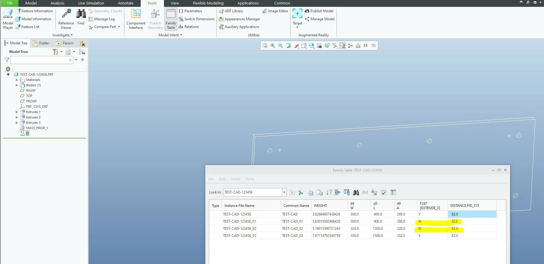

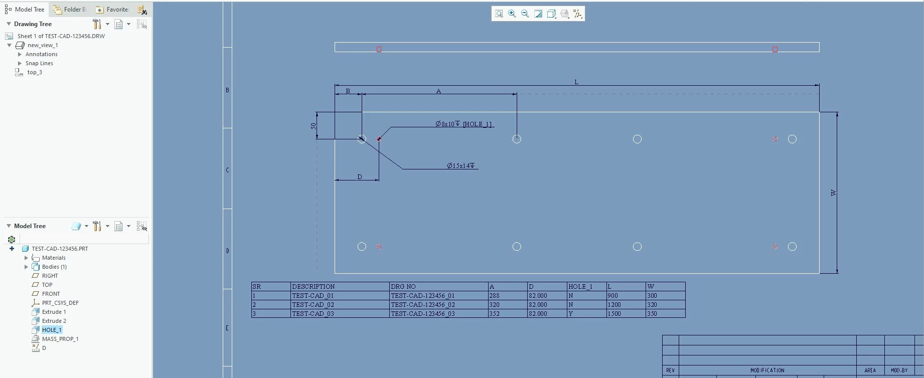

I have a generic model with hole feature and has some instances. In one of the instance the feature is set to NO while others have set to Yes. The distance from edge to the centre of hole is added as feature in generic and is part of the family table. Now for the instance where the hole is not there the dimension is displayed from the generic model.. If the dimension for the particular instance is not available then it should be set to dash or left blank . How to solve the issue?

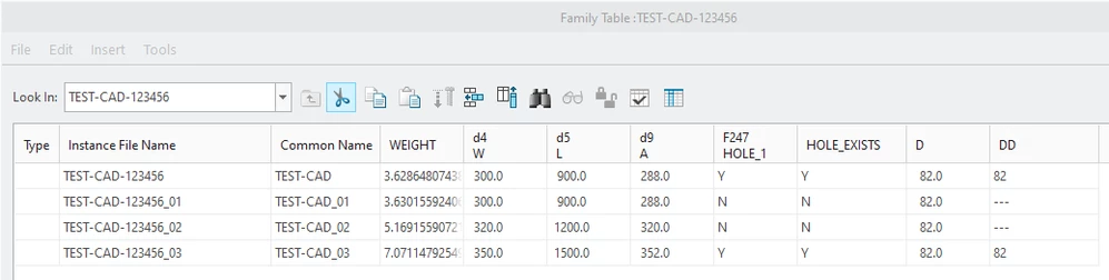

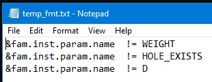

@KSHITISH_S wrote:
I have attached the drawing and part
I modified prt+drw in Creo 7.0.5.0.
prt
1.] I added parameters DD, HOLE_EXISTS
2.] I modified FT
3.] I modified relations
4.] I verified FT and saved the model
drw
1.] I modified repeat region filters
2.] resulting drawing table
I uploaded modified files.

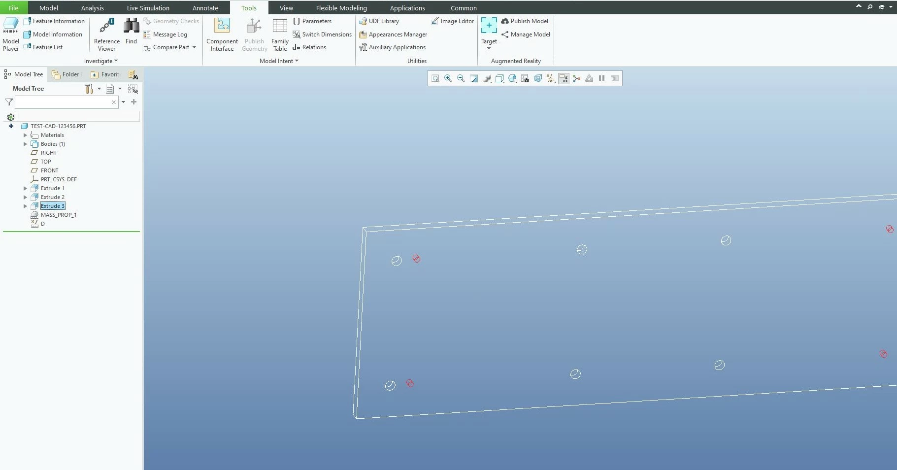

please publish some pictures showing the problem. Also pack your model into zip file and upload this zip file.
Jul 14, 2023 7:23 AM UTC
Hello @MartinHanak , I have added the screen shots
Jul 14, 2023 7:33 AM UTC
please upload your model.

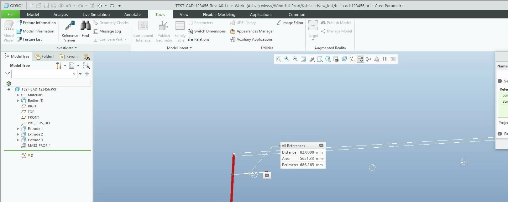

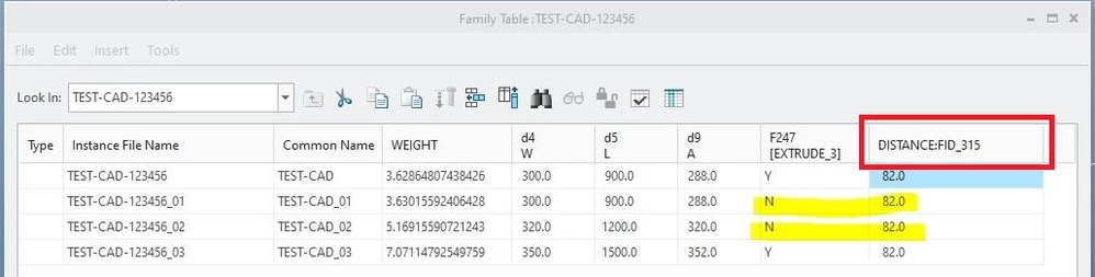

DISTANCE:FID_315 is measurement. The value is driven by geometry. Remove this column from family table. Family table usually contain variable items, only.

I want the drawing to have the L, W, A and D dimensions populated in the family table. The dimension D is for feature Hole_1 which is not in instance1 and instance 2. But in the Drawing for instance 1 and instance 2 also the dimension D is populated as 82. Person reading the drawing assumes some error in table in the drawing.
