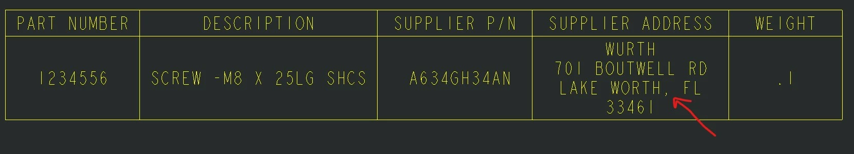

Hi Everyone,
I have a table where I'm showing the parameter values from a family table part.
I would like to have the address pulled from one or more parameters and populate a cell with multiple lines of text in a repeat region like the example in the image below.
Could someone explain how to set this up or point me to a document or URL with more info?
I have been playing with the repeat regions and filters and have had no luck getting the address cell to populate correctly.   I'm trying to used a separate parameter for each line of text.
Thanks for any help you can provide!

If each line of text in that cell is a separate parameter, just create a multiline cell entry.
In the Properties box, use:
&asm.mbr.company_name
&asm.mbr.company.address
&asm.mbr.company.city
&asm.mbr.company_zip

Hi Ben,
I'm working on a family table part file.
Would there be a way to access the family table  parameters for the part instances directly like you described for the family table assembly below?
That's what I haven't been able to figure out and I don't have access to my Pro/e 10 books to look it up.
Thank you for any help you can provide!
Don Anderson
April 22, 2020
Put the parameters in the family table generic file so they get copied t all instances. If you have multiple vendor's parts in a family table, add those parameters to the family table and populate as needed.
