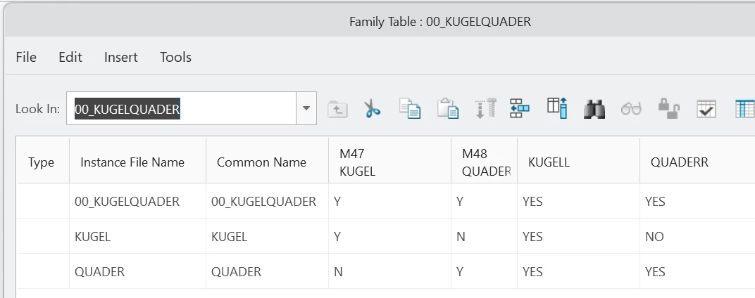

so my problem is that i have a family table with three instances (A,B and generic). Depending on the choosen one, different Features in the lower parts should be activated or suppressed. So when i try to add a column with the Features, it wont let me choose them. I also tried it with Pro/Program but with no success. Are here others ways or have i done somethring wrong?

For expample: i have a ball und a cube
in the first part i choose what i want. the ball or the cube (that works)
in the second part i want to adjust the housing form them (copie-geometrie and exrtudeted both, so i have the housing with a extrusion of a ball and one with a cube). (also worked)
Ant now i want to suppress that one feature that i dont need. How do i make this?

First update: I have managed to suppress them with pro/program and an parameter. In the moment i work on a "simpler" part to understand the pricipel befor i go to my bigger one.
A have a .asm with the generic, variant A and B.  (picture familytable)
There are also two parameters which should suppress the extrude feature (the to right ones). If i set them manuelly, it works. But if open a variant an try to regenerate it, an error (picture error) appears. The relations are correct and function, but only in the generic one.
So is there a setting to "allow" this? Or is ther a other way to make this possible?
