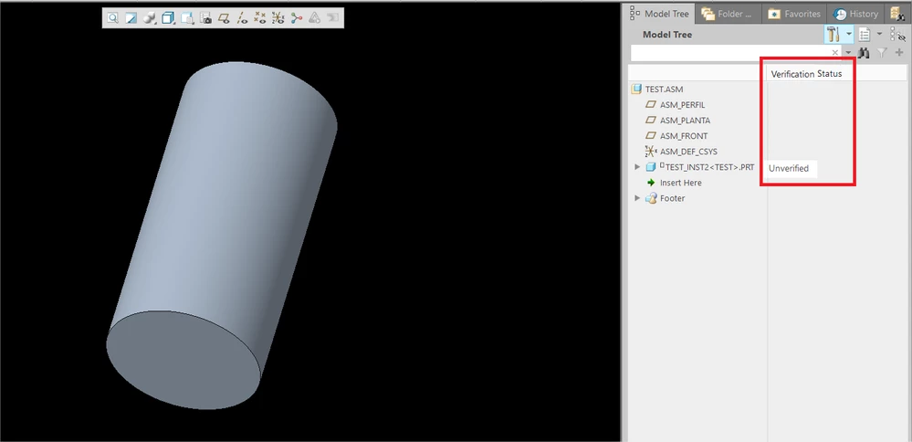

I would like to show in the Model Tree the family table parameter 'Verification Status', is it possible?

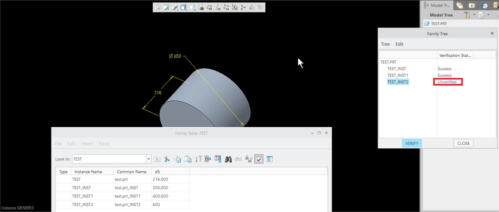

Imagine that you have an instance not verified:
This instance is mounted inside an assembly. Could you see in the assembly model tree a column with "Verification Status"?
Thank you very much

There is no way to configure this kind of information in Model Tree. Consider here that in your snapshot, the active object is the generic. and - still according to your snapshots- 2 instances are verified whereas one is not. This kind of information, if it was existing:
  • would therefore make sense in the Model Tree of instances, and not of generic models.
  • would be therefore useless, because, most of the time, it's in the generic (and not in a given instance) that users want to know if family table is verified or not (without accessing manually >Tools >Family Table >Verify each time they would like to know this)

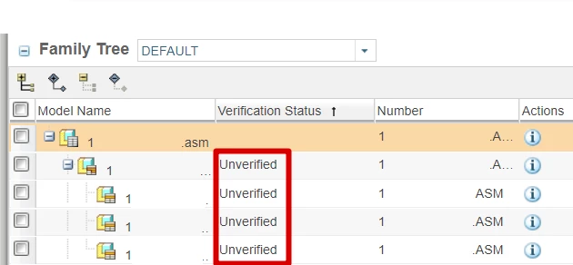

We already have the option verify_on_save_by_default yes inside config.pro, but also we have some 'families' in windchill unverified like this:
I would like a column in the model tree for have the knowledge about 'Verification Status' at a glance with models that could by done by any user of the company...
If a column is not possible, I would like access to this parameter in some way, but I can not find it... is it possible?
