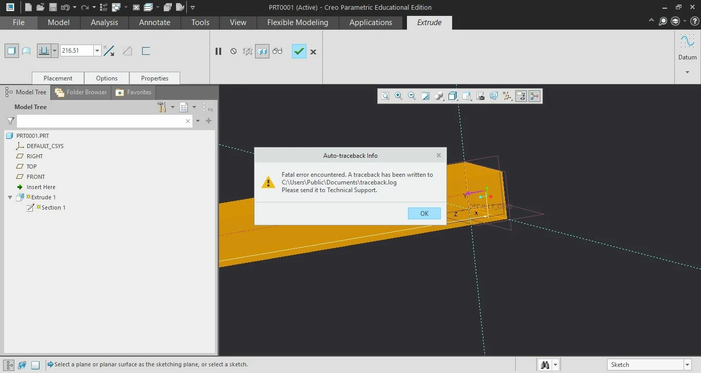

     While working on Creo 5.0 Parametric Part modeling Experience Fatal Error warning pops up and the program closes, A Traceback file is generated, Screenshot attached. Please suggest a solution.
1.] can you reproduce the problem using the same procedure ?
2.] sometimes the problem is related to graphic card drivers
  • open config.pro in Notepad
  • add following option at the end of the file ... graphics win32_gdi
  • test working with Creo

@Vue412
Can you share generated traceback file to review?

@Vue412
There are some threads about graphics ...
Try adding below config options ..
enable_opengl_shader no
enable_opengl_fbo no
enable_opengl_vbo no
Also update the Creo 5.0 datecode to latest available one.
