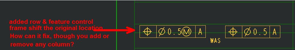

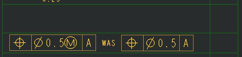

i have created feature control frame as a free note & mention in revision column. but when I suppose to add a new row the location gets disturb. How can I make same as parametric so that when I will add or delete any row its should be in that particular row.
Please refer condition 1 & condition 2
Condition-2: After adding extra row, original location shifts

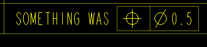

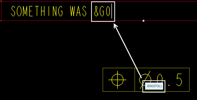

If you are creating the FCF with dumb text, you can just create it inside of the table cell. The other option would be to create it as a GTOL, place it as a free note, call it in the table using &g## syntax where ## is the GTOL ID, then delete the free note GTOL.

Where are you getting stuck? Once you have the GTOL as a free note, hovering over it will give you the ID, then use that same ID in the table cell:
Table cell will look like this:
You can then delete or erase the GTOL that is floating in empty space - the one in the table cell will stay there.
