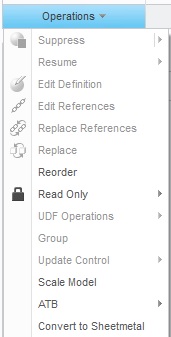

August 19, 2014
operations.jpgYes normally it must be there but I have only these

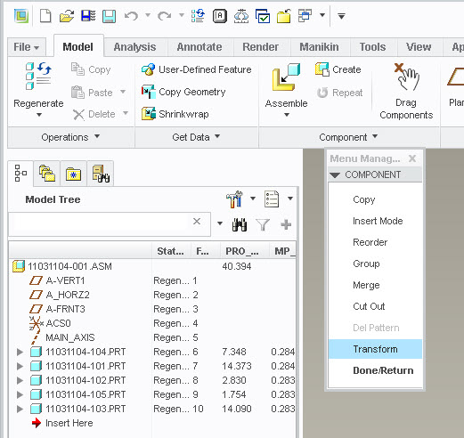

August 19, 2014
When in an assembly, transform is under component operations. Under the model tab, select the drop down arrow next to COMPONENT, then component operations. You will see transform there.
