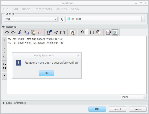

October 6, 2015
I tried the feature name method; see Mathew Ender's reply. No luck. Relations editor only accepts the lines with the feature ID included.

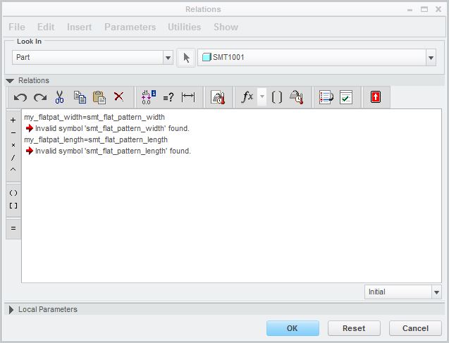

October 6, 2015
I gave this method a shot. Seems like it should work, but without the feature ID, the relations editor gives me an error. Maybe sheetmetal flat pattern parameters are different than other features.
See attached pics.
October 6, 2015
The problem is that you are making the relations in the part, not in the feature.  "By Tools>Relations>Feature>[the flat pattern]", I mean where it says 'Look In: Part' in the upper left, to select Feature, and pick the flat pattern.  The part level relations can get at info from any feature, but would indeed need to name the feature to do so.
