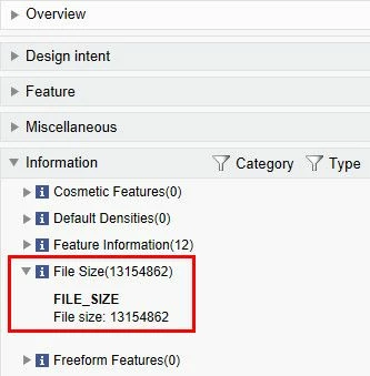

Hello, is there a method to know the file size in Mb of an assembly or part in creo or in windchill?

Jul 3, 2025 12:23 PM UTC
Open a model in Creo
Run ModelCHECK in interactive mode (File > Prepare > ModelCHECK Interactive)
Expand Information section in ModelCHECK report
There is FILE_SIZE parameter with the file size.
But in bytes, not Mb
If the model exist only in-session i.e. the model not saved yet
the FILE_SIZE will be with 'error' value
In Windchill
open a model page
open the 'Content' tab
see File Size in kb in the 'Primary Content' section

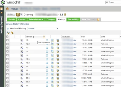

StephenW
Jul 3, 2025 3:44 PM UTC
Within Windchill PDMLink, If you view the details of a part, you can look at the "content" tab or the "history" tab, it will tell you the file size.
