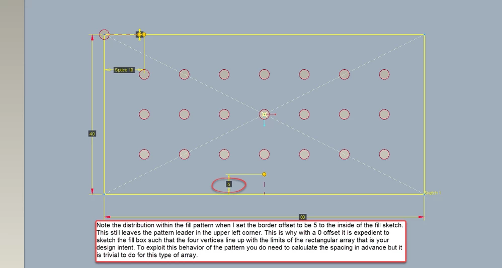

Change you pattern leader definition/dimensioning scheme. You must account for the offsets of the fill pattern in relation to the filled sketch region. This is one way to deal with this easily, by sketching a rectangle that anchors the pattern leader in the upper left corner which will work nicely for a rectangular array of fill which is what you need. Note the hole is placed at the upper left corner of the fill sketch and the offset to the interior of the fill pattern is 0. You can also get this by using the offsets in the fill pattern definition (your approach using the sketch for fill with an offset to the interior).

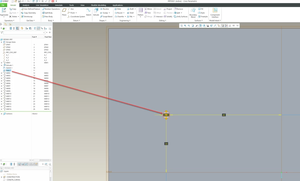

I would need access to your model to diagnose it expediently. If you can post the model, then I will have a look at it. I think the behavior you are getting is based on how the pattern leader is constrained/dimensioned (to be sure I need to query the model).
I did the test model in Creo 9 so you would not be able to open it. I would also use a hole feature and not an extruded cut (both should work in theory) for the pattern leader. Here is the model tree and the hole I used to create the centered pattern. Note the dimensioning scheme used to locate it on the corner of the fill sketch. It should make no difference if one uses an external or internal sketch for a fill pattern. I would typically use an external sketch created prior to the fill pattern being defined but that is preference. Try to mimic the scheme used for the pattern leader shown below and see if it changes pattern in your model.
