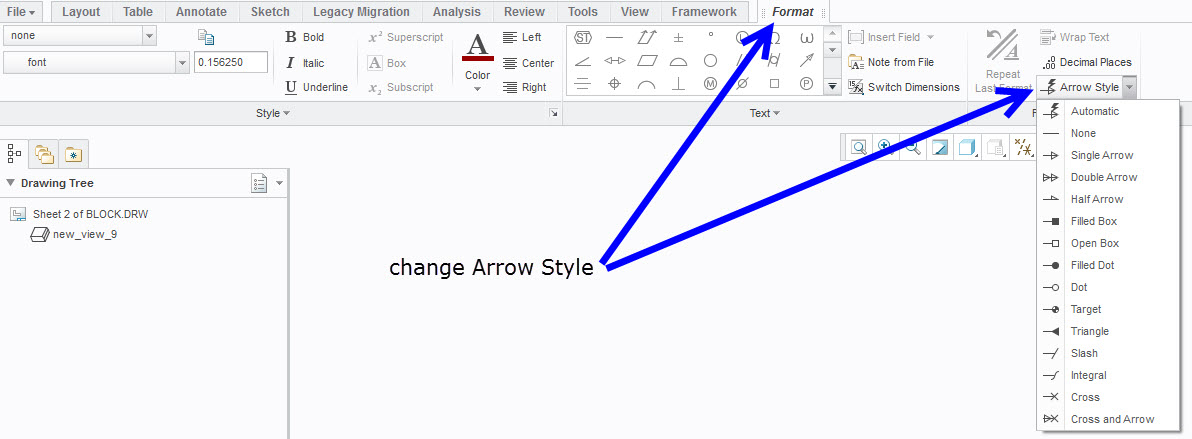

For the options to change the Arrow Style, this is now found in the Format tab.  When you select the BOM Balloon, you will see the Format tab appear in the ribbon.  Click on the Format tab and in the Format group, click on the drop down next to Arrow Style.
