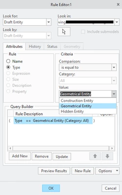

Does anyone know how to filter all solid lines to layer? What filter should I select in "Look for"? Same goes for hidden lines and xhatches.
Selecting Draft Entity does not work.
I want to move all solid (continuous) lines to one layer, all hidden (dahsed) lines to another layer, etc. I can  do this for centers, text, symbols etc, bit for these three (solid lines, hidden lines and xhatches) I have no clue what to look for. Sometimes, I wonder if PTC has a clue ...

That is not what I am looking for. I have a Layer in drawing called Main and I want to place all solid lines into that folder. Same goes for hidden lines, which should go to Hidden layer. Later on, when I export drawing to DWG format all layers should be there. I am trying to avoid using "intf_out_layer part_layer"  option because it adds part name in front of each layer's names.

This may not be supported. It appears to be incongruous with how Creo deals with the display of items in drawing views. View properties is the "standard" way to control visibility of visible and hidden lines. I have never seen drawing view line types filtered using layer assignment by rule. It may be possible, perhaps someone else that has done this will comment.
My comments are based on this information from the documentation (note that visible and hidden lines are not mentioned):
