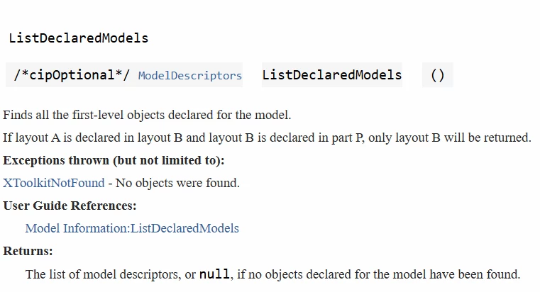

AFAIK there is no automated command available via the UI that would produce a list of all parameters where used or declared in reference to a layout. The reference viewer does not handle declared layouts when evaluating dependencies. There is a behavior built in that you might be able to exploit in this context, but I will post that in a post to follow this one.
There is a function call in the Toolkit API. Obviously to use this you would need to develop a custom application using Pro/Toolkit and it appears from the description it is not recursive so if you need it to crawl through a data set, you would need to build that logic into the Toolkit code.

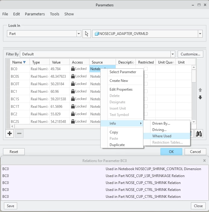

This one option that may be helpful using OOTB functionality. This is a screenshot from a part model that uses parameters from a layout. The layout is not in session and is not currently declared to the model. Even in this state (no layout in session or declared to the part), you can see which parameters are defined in a notebook and then generate a list of where that parameter is used.
You can export (save) the results of this query to a text file as shown here:
 Where Used Info for parameter BC0:
BC0 Notebook NOSECUP_SHRINK_CONTROL Dimension
BC0 Part NOSE_CUP_LSR_SHRINKAGE Relation
BC0 Part NOSE_CUP_CTRL_SHRINK Relation
