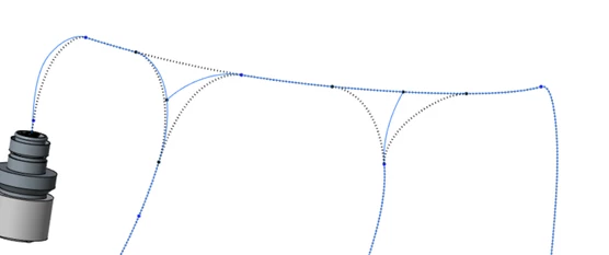

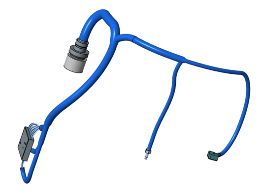

Does anyone know how to fix a missing segment in a flat harness? I have tried routing manually but it says "Cables are already layed out to this location. Select again".
The segment in the image below should connector to the branch.
There are actually two locations doing this, I assume the fix would be the same for both. Both the legs are "branch" bundles and I figure that must be related to it but I will be damned if I can figure it out.
And also if anyone knows why the flat harness wont taper or change diameter like the routed harness does that would be even better. I am less concerned with diameter. I just want to get this thing connected because I am sick of messing with it.
Thanks in advance for any help.

Here is the crappy answer.
add bend
move bend
done
