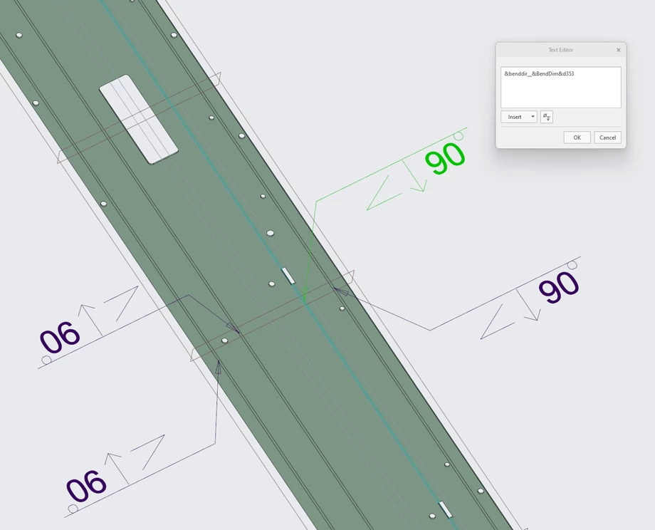

I'm looking for a solution to modify the decimal places shown in the bend note in a sheet metal flat pattern. The default is 2 decimal places & its shown in the sheet part bend note as shown in this example below:
∠&benddir__&BendDim90_00°
This needs to display as a parametric dimension in the drawing & not as a workaround.

Here is my interim solution.
Modify the unbend note to include the dimension name from the parent bend feature. If the feature was created from a shelled extrusion, remove the horizontal & vertical constraints & add a dimension representing the fold angle instead. That dimension name can also be used in the parametric note in the bend note.
Here’s the end result using the dimension name which I will use in the meantime. This is less problematic as it will at least show up as a failed parametric note if the parent dimension is deleted.
