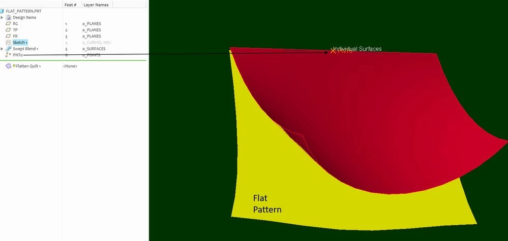

yes, I created that surface in a part. You can possibly covert the flat pattern to a sheet metal part:
BHOoi
Feb 9, 2023 8:16 AM UTC
You can use the command "Flatten Quilt" . Create an orflatten.jpgigin point as shown and the flat pattern will be created:

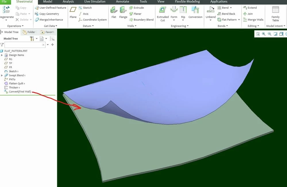

3-Newcomer
Feb 9, 2023 8:25 AM UTC
Let me correct my self. It is not a part it is a sheetmetal. And sorry for the confusion.
BHOoi
BHOoi16-PearlAnswer
Feb 9, 2023 8:35 AM UTC
