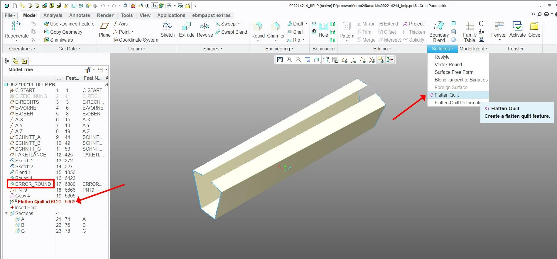

Hello PTC Community,
is there any help about my problem?
I want to create a flatten quilt from a copied surface.
Basically it works, yes.
But if I, for example, insert a rounding or chamfer, the flatten quilt fails.
Are there any ideas or solutions for this?
thx in advance
Heiko

Hi Rohit,
It is correct that the base KE is a solid.
But the surfaces were still copied to continue using it.
Do i understanding something wrong?
By the way, if you delete the round "ERROR_ROUND" KE-ID 6880, then the flatten quilt works fine. But not with the round.
hhagedorn10-MarbleAuthor
Feb 22, 2016 12:37 PM UTC
It's me again, .....
The problem is even if the construction is a boundary blend and no solid as the base KE.

sorry for my earlier post as did ot see your part properly.
Yes I believe the round at the corner is the issue.
Right now can't tell why that is so.
Feb 22, 2016 4:02 PM UTC
ok that round may not be the issue
