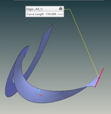

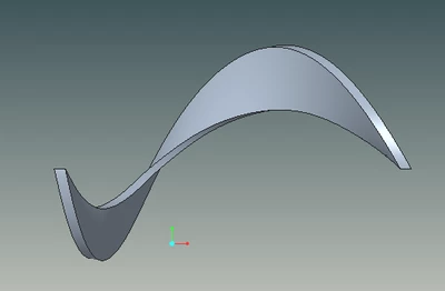

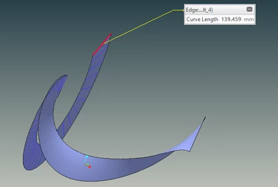

I modelled flight screw in CREO parametric with variable pitch it has revolution of 810 degree. for manufacturing purpose I need to flatten the screw flight. I tried full flight screw to be flatted by using flatten quilt, it failed, again I tried to flatten first 360 degree it was flattened but I did not get exact dimension in flatten quilt. is there any way to do the model in sheet metal or part modelling I attached image for your reference. I did not  get exact dimension it differs with flatten quilt and helical screw.
1.unflatten quilt
2.flattent quilt

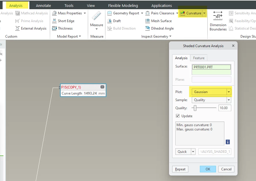

tbraxton’s reply is quite insightful. He mentions the concept of a “developable surface,” which is key in this context.
A developable surface is one that can be flattened without distortion. He suggests checking the Gaussian curvature of the surface, which is a mathematical approach to understand if a surface can be flattened without distortion. For a surface to be developable, its Gaussian curvature must be zero over the entire domain.
Gaussian curvature is a measure of curvature that takes into account both the directions of the surface at a point. In simpler terms, for a surface to be flattened without distortion (developable), it should have zero Gaussian curvature. PTC Creo, has limitations when it comes to flattening non-developable surfaces. it might be necessary to approximate the shape through a series of developable segments or use other manufacturing techniques suited for complex geometries.

Unless the shape can be developed (can be flattened onto a plane without distortion) in mathematical terms you will not get an accurate flat pattern with any of the Creo methods, and it will not flatten in sheet metal unless all surfaces can be developed.
There is an easy way to check this requirement, analyze the Gaussian curvature of your surface. The surface must be continuous and have zero Gaussian curvature over the entire domain.
Jan 13, 2024 10:33 AM UTC
I did not get your answer. I will send the image of the flight can you suggest what are the methods to be used to flatten the flight for manufacturing purpose. I have attached images for your ref
