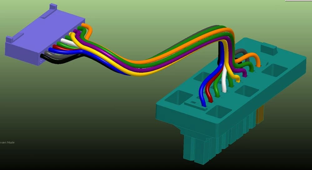

That is why I said "maybe".  If it's just a routing that is simple, you can get by with what I mentioned.  If you're "threading the needle" around standoff and thru grommets, then no.  What I would do in that case, is create a cable assembly for that routing.  So, you have an assembly that uses 1 or more cables and its filename is:  "1234.asm", and your cable filename is: "5678.asm", then make a cable assy 1234_5678_route-01 (-02, -03 etc. for different routings of the same cable).  As mentioned, I established a system of connector constraints.  So, create the cable routing assy, insert the first connector at the default CS orientation, then constrain that assy at the upper level target assy where the cables are used.  Then make that particular cable routing assy "Active", and add the second connector to that cable assy but using the mating connector CS at the target upper level assy.  This creates a parent/child relationship, but it is pretty much unavoidable unless you're doing top-down design using a skeleton or master model.  While still in the cable routing assembly, now run your wire routings pin to pin between the 2 (or more) connectors.  This cable is now parametric (unless the routings fail) so if the location of either connector or grommet moves, the routing will change.  Since you're never using this particular routing anywhere else, (another assy or dwg), the affects of the parent/child relationship are not a big deal.  If you HAVE the cabling module, I'd use that, if not, you can do it manually as I mentioned.
Either way, it's either a challenge (as I took it), or a PITA, it just depends on your outlook on it.  Best of luck, and post pics of the result.

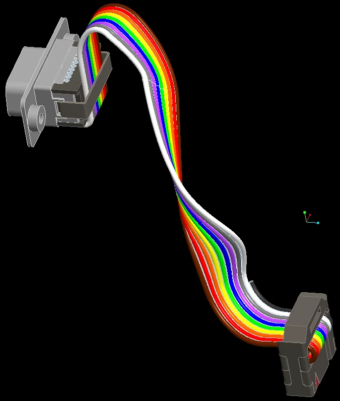

Here's a couple I did years ago, the ribbon cable with 180deg twist done in maybe 2007, the other one done in maybe 2013.:
Note, if you do a twist like that ribbon cable (or even just wires, there MIGHT (WILL be with ribbon cables) be an issue with the cross section of the wires being incorrect unless you get the trajectory right.
