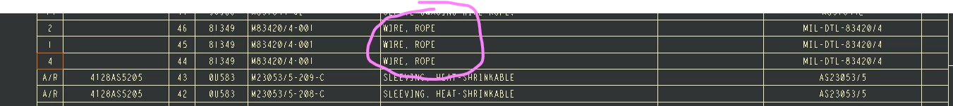

All,
CREO 8: Is there an easy way to not have multiple lines in bom for flexible components in assembly? No duplicates or No duplicate level does not work. I saw something about editing the bom. I did not understand it
I tried using family tables instead of flexible models, but having the same problem with multiple lines.
WayneF
18-Opal
July 15, 2026
I think the entire row is unique - hence you have the same items with other properties that are unique in the report.
