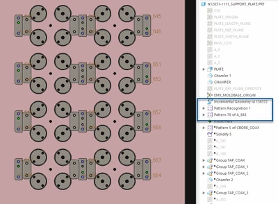

Hi Guys,
I've been playing around with the flexible modeling, as I have never really used this before. (im in Creo7.0.2.0)
The one thing that peaks my interest is the pattern recognition.
Lets say i have a very large plate that has hundreds of holes in it, that were done with a solidify. (so no axis exist yet in the holes.)
I can get the pattern recognition to see all the holes and make a pattern in my model tree. But how do i utilize this newly created pattern recognition?
I want to use newly created pattern to make hundreds of axis lines through all the holes it just found.
But i only get 2 when i try and create an axis line in a hole, and then pattern that. What am i doing wrong?
Jay

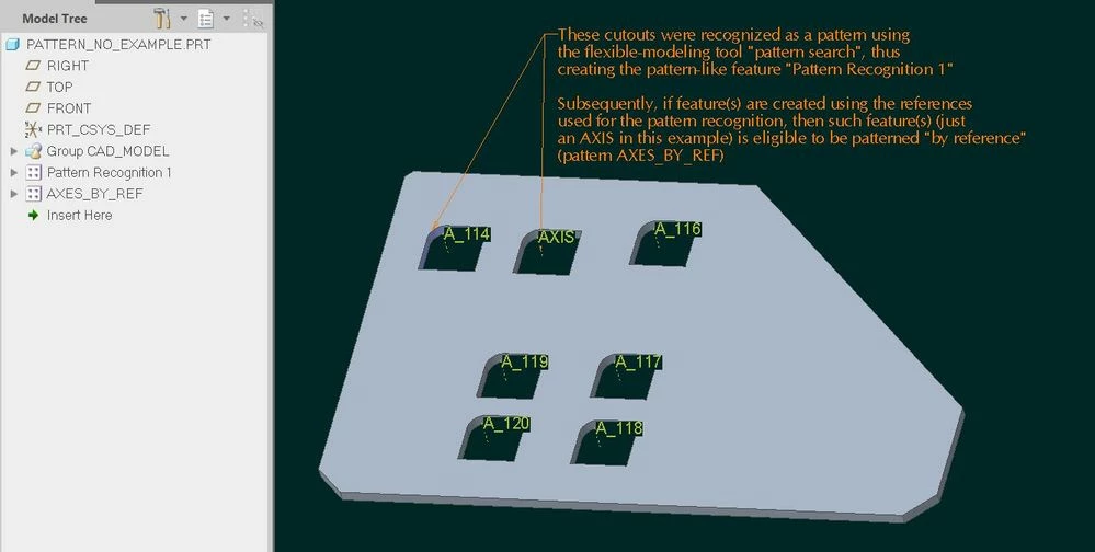

Sounds like what you are doing should work, though I am not actually clear how you are defining your axis.
It has to be related to the features that were used to drive the pattern recognition feature.
I tried it in Creo 4:
I think one has to be careful with references.  I also notice this pattern recognition does not 'auto-update' - so if you insert more holes, you will have to edit-definition of the pattern recognition feature in order to "refresh" the pattern references.

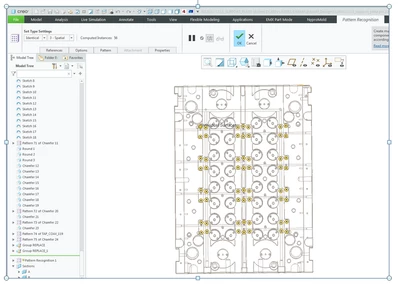

So when I run pattern recognition, It finds 56 instances. Great!
I accept that, and then add an axis to the hole i used for pattern recognition.
when I pattern that axis, I get only 2 axis created.
I also tried it in creo 3, and get the same result. So maybe its the way the holes were originally created. (I believe they were put in by solidifying a copy. )

In my limited experience, I've had issues with this tool: the new pattern put all the new axes on top of one another - but you are only getting 2 - so you aren't really getting the "pattern by ref" action (which should give you 56 instances).  So is your pattern 76 actually a pattern by-reference?  Can you post your model?
January 12, 2021
I'm wondering if the pattern is getting confused by the other "stuff" inside the solidify. I've also seen this issue in the past and it normally means some reordering of the model tree needs to occur or some simplification of features. In this case, your features are at the top so all good. I can't comment on simplification.
Instead of stepping out the part, you could try collapsing the 4 solidify features into an independent geometry using the collapse command. I tried this and afterwards I was able to make the pattern of axis the way that you want. Might be a bit cleaner too as the solidify features are currently referencing the drill or whatever that is that made the holes.

Did you try redefining the Pat Ref and change Identical to Similar?
Also, when you created it, did you pick the feature, create Pat Ref, then select the exact same surface for your axis and then pattern it.
