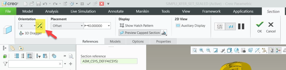

tbraxton
Jan 23, 2025 12:56 PM UTC
Creo has a button to flip the view direction for a cross section. In the section creation UI use this button to flip the direction.

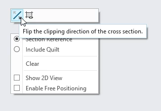

MikeBennett
Jan 24, 2025 8:45 PM UTC
This button is also the first icon in the Mini Toolbar when defining the section.
