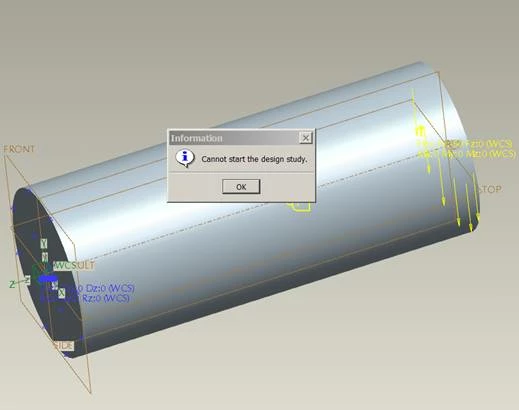

Pro/Gurus,
I am a newbie to Pro/Mechanica (used to Algor/Autodesk Simulation).
When I try to run a Pro/Mechanica analysis, I get "Cannot start design
study" error. I am able to add loads, constraints, material properties &
constraints though. The floating module shows Struct_simulation added to
my session.
What am I doing wrong?
Jay
WF 4.0, M100
________________________________
October 3, 2011
Jay,
Are you sure you want to run a "design study"? Normally you would just
do a "static analysis" unless you want to vary some parameter/geometry.
If you mail me the model i'll be happy to look at it.
Best regards,
Patrick Asselman
