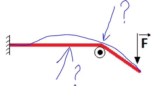

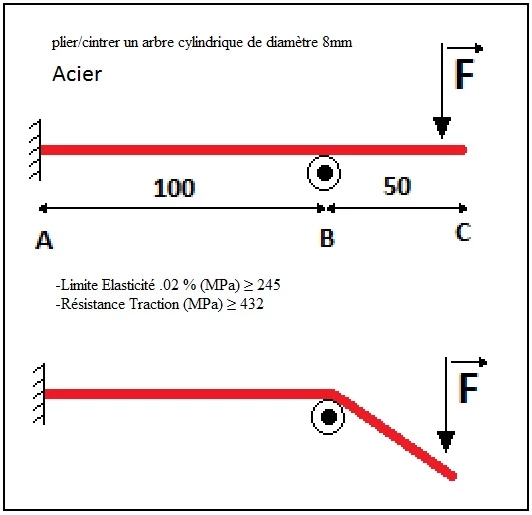

Hello
How is it possible to simulate the force required to bend this
steel bar under the terms of the attached drawing.
You must enter the information of the steel to exceed the elastic limit.
Simulate 3.0 is it able to do
Kind regards.
Denis

December 11, 2016
Hello Paul,
Thank you for this video.
But the bar does not slide, it remains fixed in the wall.
It's just the part B - C which must bend turn to point B.
And the question is how much force should be applied to achieve this result?
Kind regards.
Denis.

December 12, 2016
Denis,
    Maybe you can have a try by following these steps:
    First,you should know the vertical distance between point C and point C' when the bar bends down;
    Then set a forced displacement(prescribed translation) which equals that distance;
    The third,make a force measure of the forced displacement,hope these can help you!

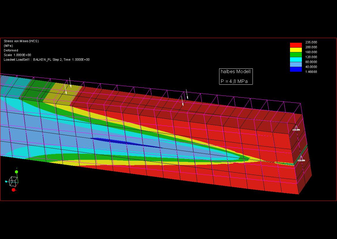

December 12, 2016
The Problem is the plastic collapse, for exmaple:
Regards
Paul
December 12, 2016
Hello Paul,
Thanks for this example.
You mean the plasticization of beams in soul full in flexion.
Simulate can't go this far in the calculations.
Kind regards.
Denis.

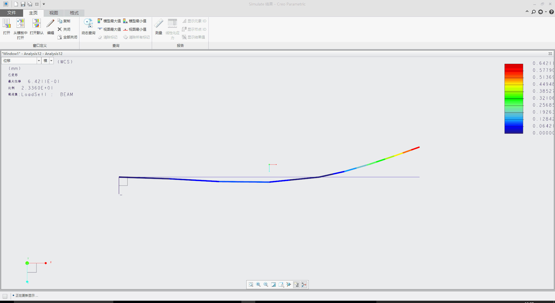

December 21, 2016
The size of the force is 245N
you can use optimized design studies

December 24, 2016
"blockages " means constraint?
I used the optimized design
The beam.prt.1 can be opened by creo 4.0

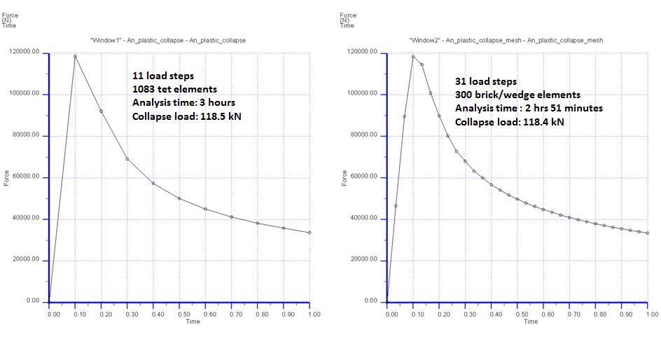

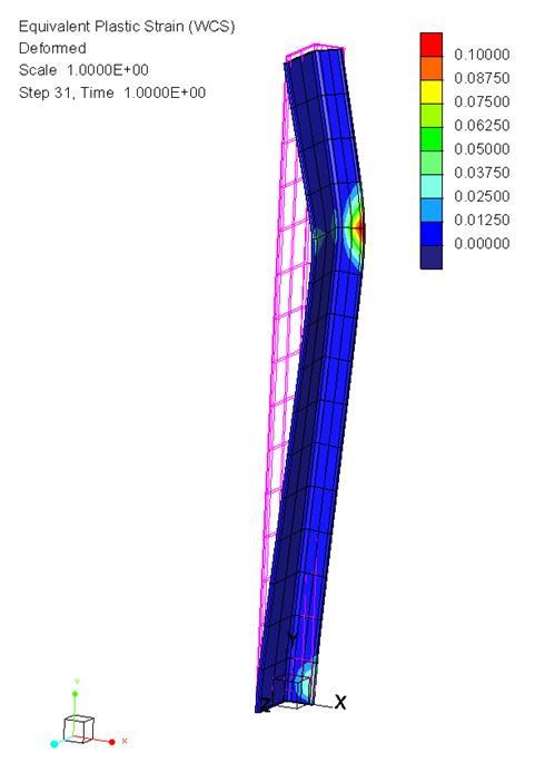

January 9, 2017
Yes, Denis, it is possible to analyze this, but you will have to use solid elements with material plasticity, and also large deformation analysis + contact analysis. If you want to model the plastic collapse, you cannot model the load using a "load", instead, you will need to model the load using an enforced displacement.
The nonlinear solver is sensitive to mesh, I advise to use brick/wedge elements to model the beam.
Here are a few pictures from a plastic collapse analysis I did a few years ago. I recall that I also had an animation, but I can't seem to find it. Unfortunately I can't run Creo where I sit now, so I can't re-create these results.
In this case I have no contacts, but the load is axial, and what you see here is post-critical behavior, if you enforce a vertical displecement, along the edge of the beam end.
/Mats L/
