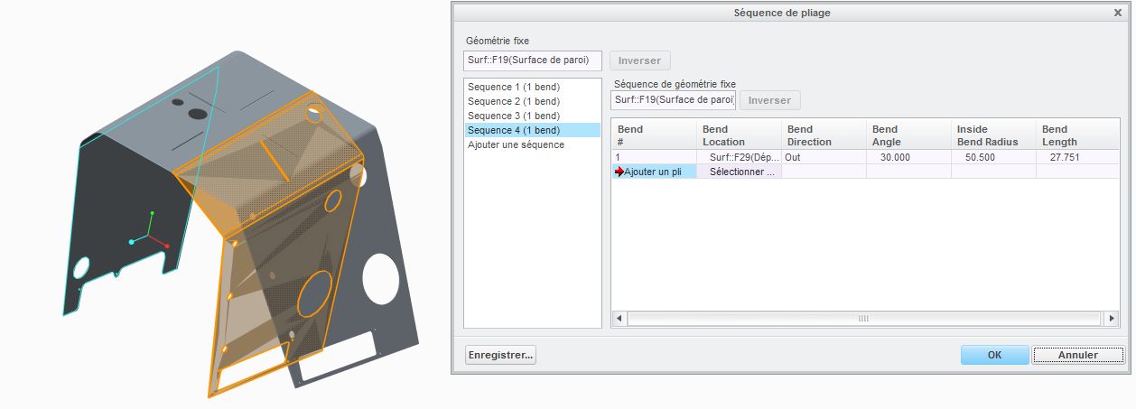

In creo parametric,  i create a bended sheetmetal part, then i define a bend sequence.:
If i want to retrive the bend parameters in a drawing, a default note is created because i defined a bend sequence earlier :

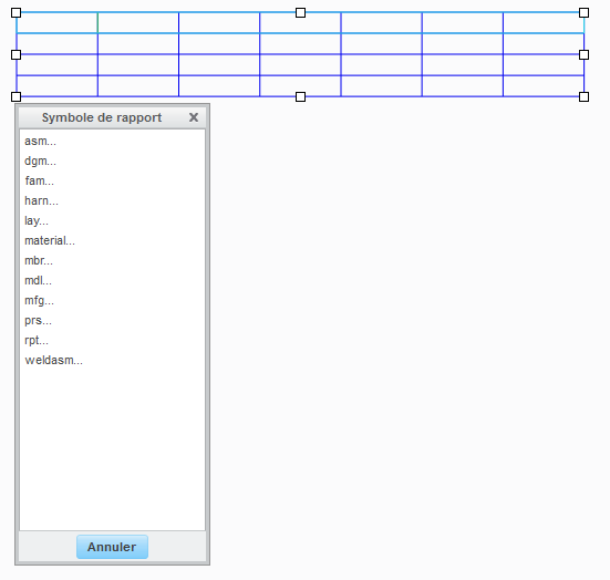

The real solution it to create a repeat region with my customisable text in it / and bend parameters, only problem is :
WHY THE BEND PARAMETERS FOR SHEETMETAL PARTS ARE NOT AVAILABLE???
WHY PARAMETERS FOR CABLING INFOS, bend for PIPES ARE available and nothing for Sheetmetal :
These parameters exist since they are retrieved in the default table not i showed in the begining
==> Sheetmetal Bend parameters  MUST BE made available for repeat region PARAMETERS <==
