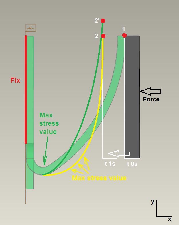

I have a task, see attached picture. There is a simple spring loaded by a force on the top. If the spring is attached by the force directly on top then the convergence is OK. (See Case 1). If the force attaches the top red body (Case 2) then already the step 2 is not able to converge. If I define a displacement instead of force then the convergence is OK for both cases.
My interface type is Contact, and I used linear material model.
What do you think? What is the problem with the force loading on the top body?

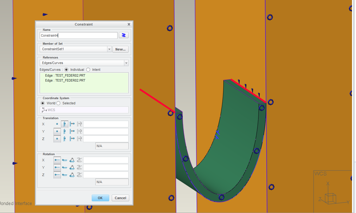

thanks a lot. You are absolutely right. I did not fix the direction of top body. I corrected it already.
I checked Paul's test model. I detected that the red edges are fixed in direction X. By this way, the spring will deform only but it is able to motion. Am I correct?
Please check my original geometry below:
The green part will be bended by a force acting on grey part. If the red point is fixed in direction Y - point 1 moves to point 2 - (based on Paul's suggestion) then the yellow deformation will occur. But, if the red point is not fixed then the result shows the green deformation with different stress value. (Point 1 moves to Point 2'). It is evident that the convergence is more stable with the fixed red point but in the real, the green deformation can be seen, I think. The main problem is that this solution will result a slippage and friction force in the red point which continously causes unstable convergence.
What do you think? How can I set the interface to increase the stability of convergence? Larger friction coeff? Or should I define it without friction? Perhaps finer mesh in direction of slippage?
Thanks for your suggestions:
Roland

Yes, it is a real problem of course. The green part (in my previous comment) is the original spring.
OK, thanks your suggestions and the pdf file. I dont know that the "contact with finite friction" solution includes errors.
Finally, I fixed the red point in direction Y, and red fix support line (left side) also can move in the same direction. (I think, the final result is same to the green deformed spline in terms of deformation and stress.) Now the convergence is ok and there is not slippage during the full process.

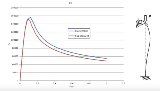

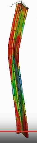

I have not read all posts above, but if your structure "collapses" in the sense that its stiffness first increases and then decreases, your analysis will not converge with a continously increasing load. It can't. You will have to apply you load using an enforced displacement, as I did here in this plastic collapse analysis. The displacement was prescribed, the force was detected using a reaction load measure. You will reach the critical collapse load, and then the structure's response will be weakening; the force required to continue to deform the structure drops once you are past the critical collapse load.
Here is my complete presentation, unfortunately in swedish... Nya elementtyper i Creo Simulate - YouTube
I created this presentation as Creo Simulate promotion some years ago while working for a ptc reseller in Sweden/Norway.
