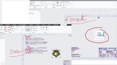

Format / Drawing / Bringing an image object the right way
I In .drawing the way to bring an image is clean and nice resolution. WHY in .format, it has different setting for Layout? No Images option!
What is the best way to bring image in format the same way as in drawing?
Thanks in advance!

Dec 18, 2025 10:10 AM UTC
to get an explanation you have to contact PTC Support.
My suggestion ... use drawing template instead of drawing format.

Dec 22, 2025 9:55 AM UTC
Create a symbol of the image. e.g Company Logo.
Insert the symbol. One can insert symbol both in Format and in Template and scale them too.
