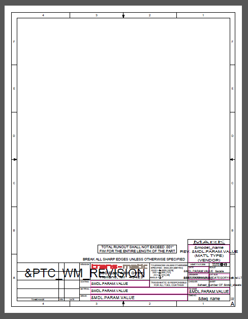

Currently reworking our formats and templates. Debating between filling the paper electronically and then printing scaled to fit (based on the printer) vs. leaving a border electronically and then printing full scale. There seems to be pros and cons to each method, not to mention the intricacies of printers, plotters, PDF viewers, etc. Curious what other's are doing, and why.
Border (A Size):

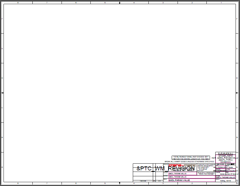

No Border (C Size):

I guess it is a matter of personal preference. We use the "No Border" approch here. Leaves more room for the CAD data. We print our drawings to scale so we don't use any printer scaling. Not that scale is needed for most of our drawings but, we do have some punch templates where it is helpful.

So if you have no border (extra white space), and you print full scale, doesn't the title block, zones, and anything else near the edge get clipped by the printer?
April 23, 2015
The border is thick enough that part of it shows up in the printable aria. The screenshot below shows this. Every time we change plotters it takes a bit of work to get everything setup correctly again. I set a zero margin in the printer settings and the print driver settings. I also had to set the printer not to scale (It was automatically scaling drawings down to fit by default). Most lazer plotters can almost print to the edge of the paper now so I don't have any problem seeing the zones on prints but the outer border seen in the PDF does get clipped when plotting.

I think I need to clarify. If I draw the outer border the exact same size as the paper, when printing at 1:1, the outer border and most of the zone marks will be clipped off by the printer. That seems to defeat the point of showing the zones. From the comments above it seems that the preference is to fill the paper but also print at 1:1. This will necessarily clip the borders. Maybe this should be a poll instead. Which option do you prefer (1, 2, or 3):
Outer Border Matches Paper Size
1.) Print 1:1 = Most, if not all of zone marks will get clipped but scale will match
2.) Print scaled to fit = Both borders and all zone marks will be visible but scale won't match
Outer Border Is Offset In From Paper Size (1/4" to 1/2")
3.) Print 1:1 = Everything is visible, and the scale will match, but there is more wasted space (especially noticeable on electronic copies)
By the way, the first picture above ('A' size) is option 3. The second picture ('C' size) could be used for options 1 or 2. (Don't let the gray confuse you. I'm only talking about the white areas in both pictures and the border's relationship to the white edges.)
