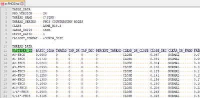

In your hole tables, you can define the string you want to use under the parameter FASTENER_ID and call it out with the token &SCREW_SIZE, e.g.:
Sep 3, 2025 8:00 PM UTC
Can't figure out how to get my note to show up as desired.  Can you take a look at the above and point out my mistakes?

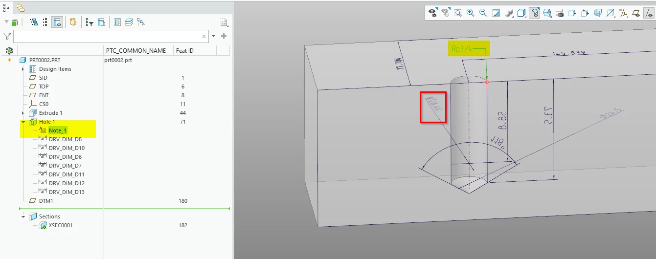

May 19, 2026 7:25 AM UTC
Hi Pausop
I’m suffering similar problems, but asking in the context of hole feature.
I made all the adaptions in the standard tables as mentioned.
The callout seems to be the text info presented in the yellow marked info.
My request would be that this is to be presented in the red marked Annotation instead.
I like to present it on a drawing in section views where the dimensions are with diameter dimensions with witness lines.
Do you have any idea how this can be implemented in practice?
