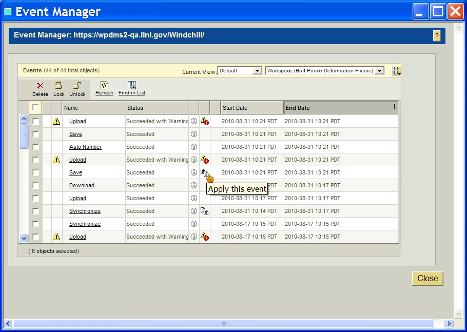

Using the Event Manager
[cid:image001.jpg@01CB9793.3F1923F0]
As you can see from the event manager shown above, not every event records a frame. The frame event icon looks like this:
[cid:image002.jpg@01CB9793.3F1923F0]
Look closely at the Event Manager shown above. You will notice that the last time I saved, (the 2nd row), has not generated a frame yet. A frame for that save will be made the next time I save.

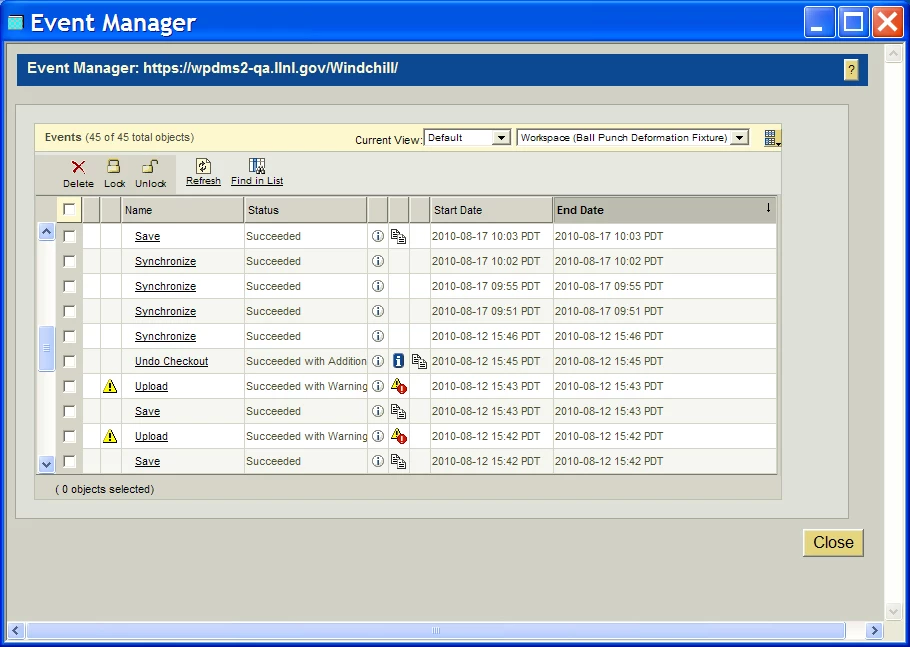

[cid:image003.jpg@01CB9793.3F1923F0]
Notice in the image above that the saved frames span multiple days.
The likelyhood that your going to be successful in applying a frame from a different day, is pretty slim.
Also notice that you can't tell from the event manager what object & workspace that frame relates to. You would have to look at the information on that event to tell what object it relates to.

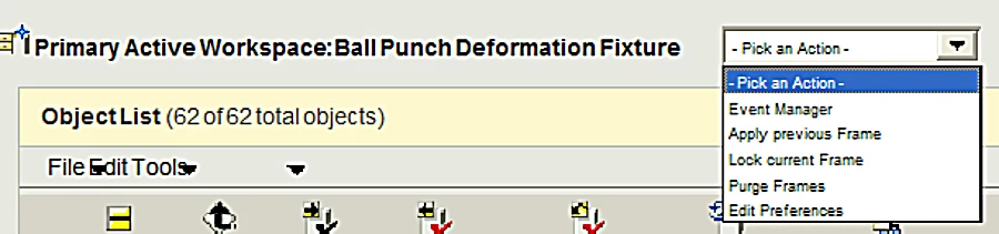

Workspace Frame Menu
The other way to use frames is to pick Apply previous Frame from within the workspace menu.
Please note that if you open an existing file from your workspace and start making changes to it, no initial frame is recorded. Therefore there's no way to revert back to the unmodified file, except for erasing it from memory. Once you save, then a frame is recorded.
[cid:image004.jpg@01CB9793.3F1923F0]
Apply previous Frame - If there is a previous frame for this workspace it will be applied.
Warning, if you pick Apply previous Frame multiple times, you're not stepping back in time, you're toggling between the current and previous versions.
Lock Current Frame - Places a lock on the current frame so it will not be purged or automatically deleted.
Purge Frames - Purges all the (unlocked) past frames associated with the workspace. The most recent frame and any locked frames are not purged.
These menu options will not show up if the Workspace Frame Stack Size is set at 0. Zero is the default.

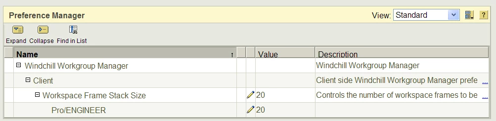

Setting the Workspace Frame Stack Size
Pick the Home Tab, Utilities, Preference Manager
Set the Workspace Frame Stack Size to the number of frames you want the system to save. 20 should be more than sufficent.
[cid:image005.jpg@01CB9793.3F1923F0]
Note - once the limit is reached the oldest frames in the stack will be deleted as new frames are created. Locked frames will not be deleted.
