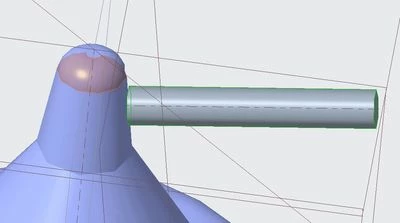

Fuse the rod with the main body
Hi, I wanted to ask that how do I fuse this rod to my main body ?
Should I use the welding option?

Two options:
Easy:  Extend the length of the rod so it is inside the main body
Correct: Extrude the rod and use the extrude up to next surface option so that it intersects the surface of the main body explicitly.
tbraxton
I do not think weld feature is what you need. It appears that your main body is surface and the rod is solid geometry. Solidify the main body geometry then modify the rod such that it intersects the main body yielding a single solid.
I just done solidify the main body and I found out that there is still a gap between the rod and the main body. How to make sure that my plane is parallel to the inclined surface?

Two options:
