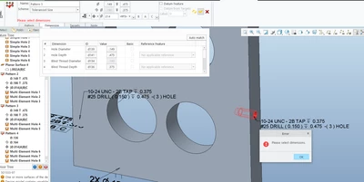

GD & T advisor question
I created numerous tapped hole patterns and added GD & T call out with no problem. On this hole pattern I cannot add the GD & T call out,. It is asking for a dimension reference. I have tried picking the dimension, but will not work. e other patterns did not require me to pick a dimension? What am i doing wrong

not sure how many users own the module GD & T. Maybe it would be better to contact PTC Support.

Hi @bchapman
While it is hard to evaluate from the attached image, I do have one suggestions that works in some situations.
Please define the surface on which this hole is cut from as a GDT feature. make sure that you define that surface (maybe as a datum) BEFORE you are trying to add this new pattern.
In many cases this resolves the issue because the reference surface is defined. If this doesn't help, please report a tech support ticket, so that we at PTC can take a deeper look and investigate with your model data
