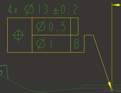

Hi all,
how can i get my composite control frames to look as intended? I am using Creo 7 professional.
I get this in the drawing but it looks fine in the model

Add this detail option to the drawing and update the sheet.
stacked_gtol_align no
October 22, 2021
Thank you, this was exactly what i was looking for !
