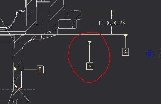

I'm fairly new to Creo and having difficulty removing a datum from one of my drawings.  What appears to be happening is the feature that it was tied to is no longer there.  So, now I'm unable to select it to delete it, or tie it to a new feature.  The datum is just dangling in space.  See below.  Any ideas on how to remove it?

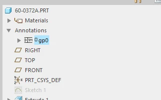

Usually they're tucked under the 'Annotations' section at the top of the model tree (not in the drawing.)
September 25, 2020
I appreciate all your help regarding this issue.  So, I went to the annotations tab in the model tree and it doesn't appear to be there.
Could it be located somewhere else that I'm not aware of?

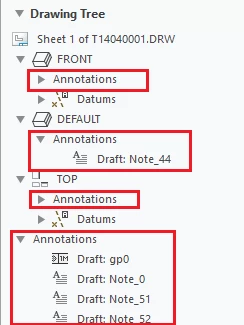

September 25, 2020
Go to the 'Annotate' tab in the drawing and then look in the tree under the 'Annotations' section of each view.
Note:  I'm currently using Creo 6, so it's possible this is slightly different in Creo 4.
