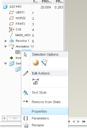

Additionally, when I'm finished creating my GD&T, it doesn't seem like I can edit once I leave the dialog. It will create a new node in the tree. Is there a way to edit the GD&T or edit their linked features?

In the model tree, If you expand the annotation feature and then you can right click on the GD&T you want to edit, click properties.
