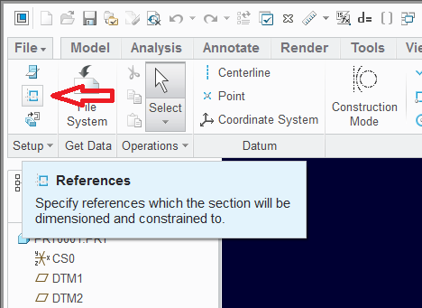

I'm following this link How to model spur gear in CAD to create an involute gear profile but the base dia, pitch dia, outer dia and curve are all different layers so when I try and create the points needed for the next steps in creating the "tooth" the geometry is non selectable for the point to snap at the various intersections and points.  So this is probably a layer question where I would like to edit the layers "beneath" the sketch or bring the geometry forward so I can edit within a sketch.  I'm using creo 3.

Give us a hint - the steps are numbered - which step is sticking (I'm guessing 5 or 6)
Aside from that, I suspect that you have the selection filter set to something besides ALL, because otherwise you would be saying you could not see the curves to select them.
The Layer concept in Creo is that it is a list, usually to manage visibility, not as geometry overlays that bitmap graphics have, so there is no 'beneath' to them.
If you can see the geometry you can select it.
If you can't see the geometry, then you can change the visibility of the layers under the layers menu.
November 18, 2016
First define the references.  After that, new features will snap to them within a sketch.
You can always make them members of the same layer, but be careful if some operations are done using layer filtering/selection.
