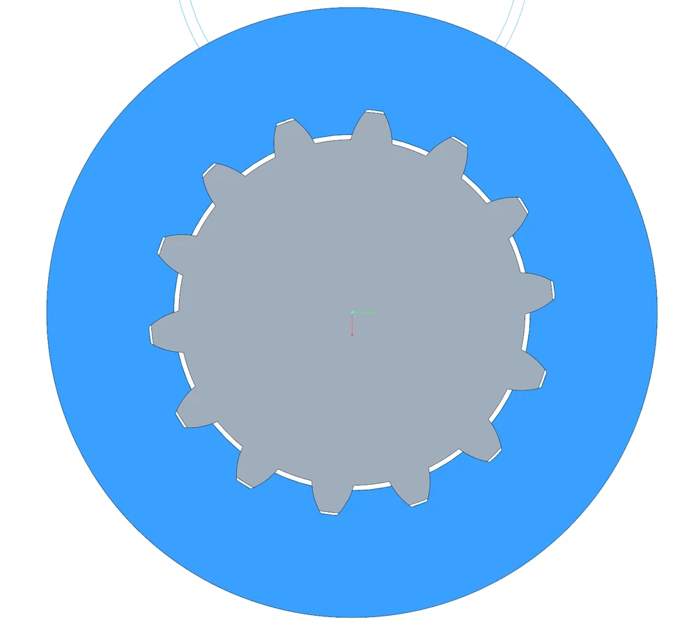

I drawing  2 part:
  • shaft
  • Hub
I want to linked it with gear teeth  (involute profile)
i drawing involute on shaft and hub with the same parameter
when i assembly shaft and hub  i find low profile decal.
in the hub, i use a simple function for cut teeth profile
in the shaft, i use un sweep function
perhaps this decal come from sweep ?
i am sure of my involute
anyone have an idea ?

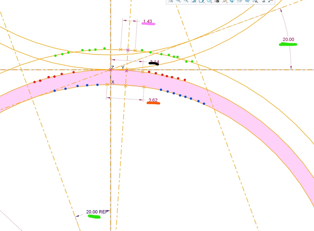

Another way to drawing gear without mirror feature
only use :
  • modulus = m (or DP if you want )
  • tooth number = Z
  • contact angle = ALPHA (green)
1/ make primitive radius : R = (m * Z)/2  (red point)
2/ make head circle :  RS=  R + m    (green point)
3/ make base circle : RB = R*cos(ALPHA)   (blue point)
First , we calculate the intermediate angle (angle of incidence)
TETA=acos(cos(alpha)*(R/Rs))  (it possible to check it, after in the sketch)
TETA1=tan(ALPHA)-(ALPHA*(pi/180))
TETA2=tan(TETA)-(TETA*(pi/180))
TETA3=TETA1-TETA2
Note : here i use a involute equation 😉
And now, we calculate the tooth thickness
1/ thikness @ primitive circle :  E=(Pi*m)/2  (black line)
2/thikness @ base circle : EB=R1* ( (E/R) +2*TETA1 )  (orange line)
3/ thiknesse @ head circle : T=RS*( (E/R) + 2*TETA3 )   (pink line)

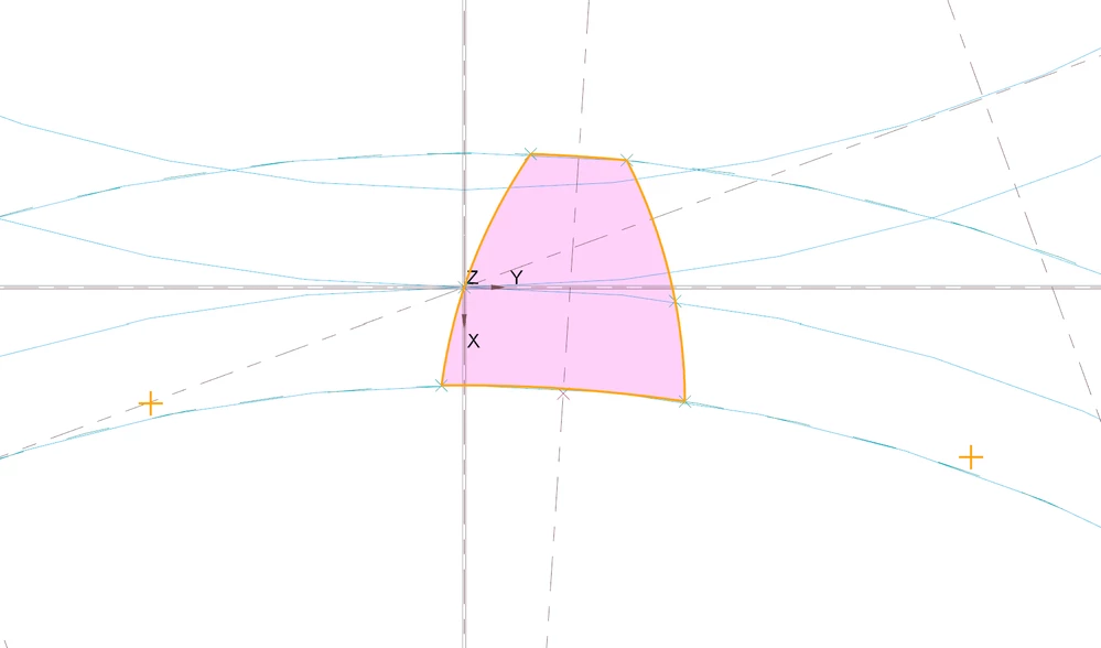

now we can drawing a sketch:

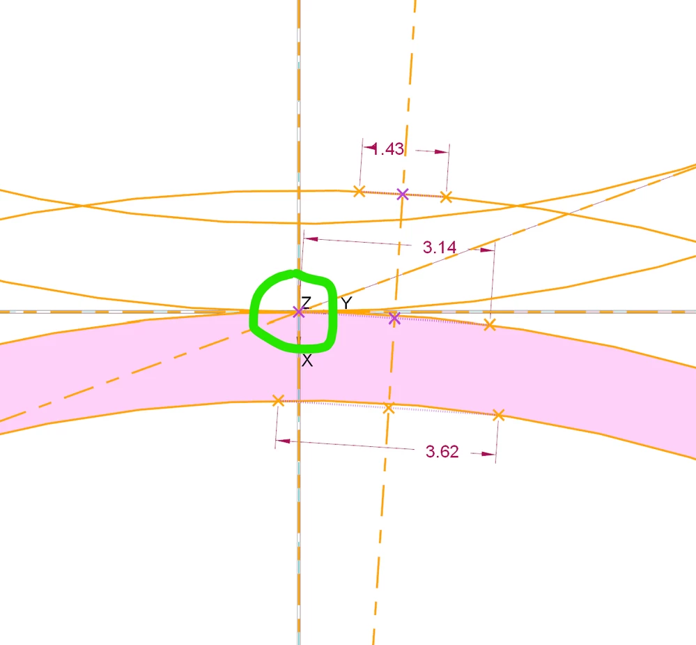

the origin is the contact point of gear pair (green circle)
and finally, you drawing a arc circle with 3 points
obsiouvly, if you use diametral pitch DP  instead modulus
use this  : M * DP =25.4mm
example DP 4   give :
modulus : 25,4/4= 6.35
now we can apply feature at this sketch ( extrude or sweep) and we don't use mirror feature 🤣

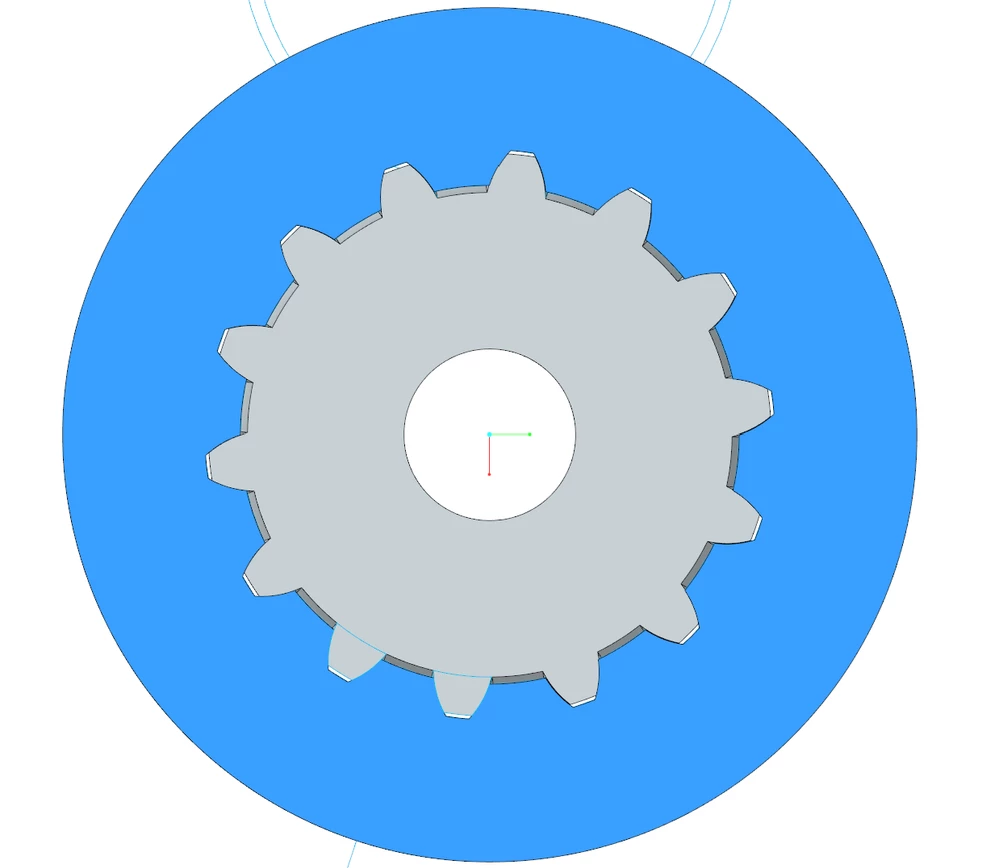

Dec 8, 2022 7:31 AM UTC

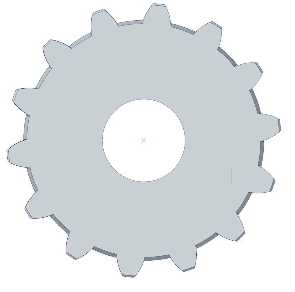

first, i drawing hub and shaft with extrude feature
the involute profile is good, i make it with involute equation
this result is perfect!
see this picture

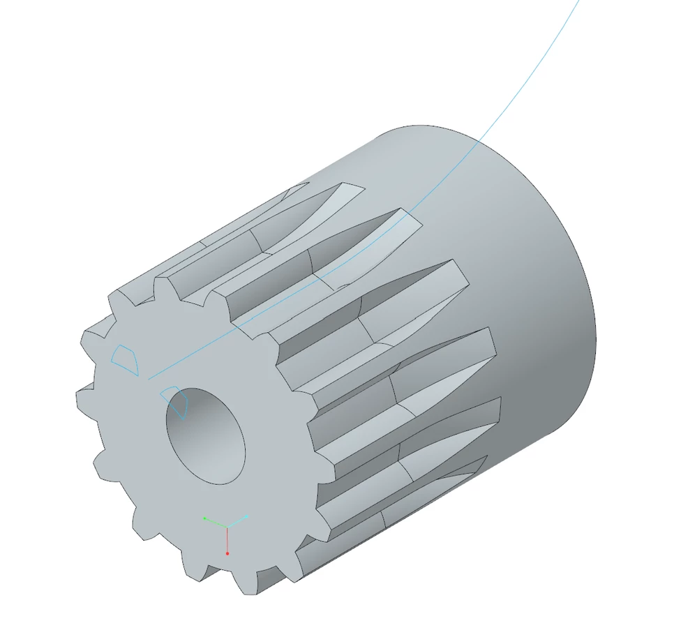

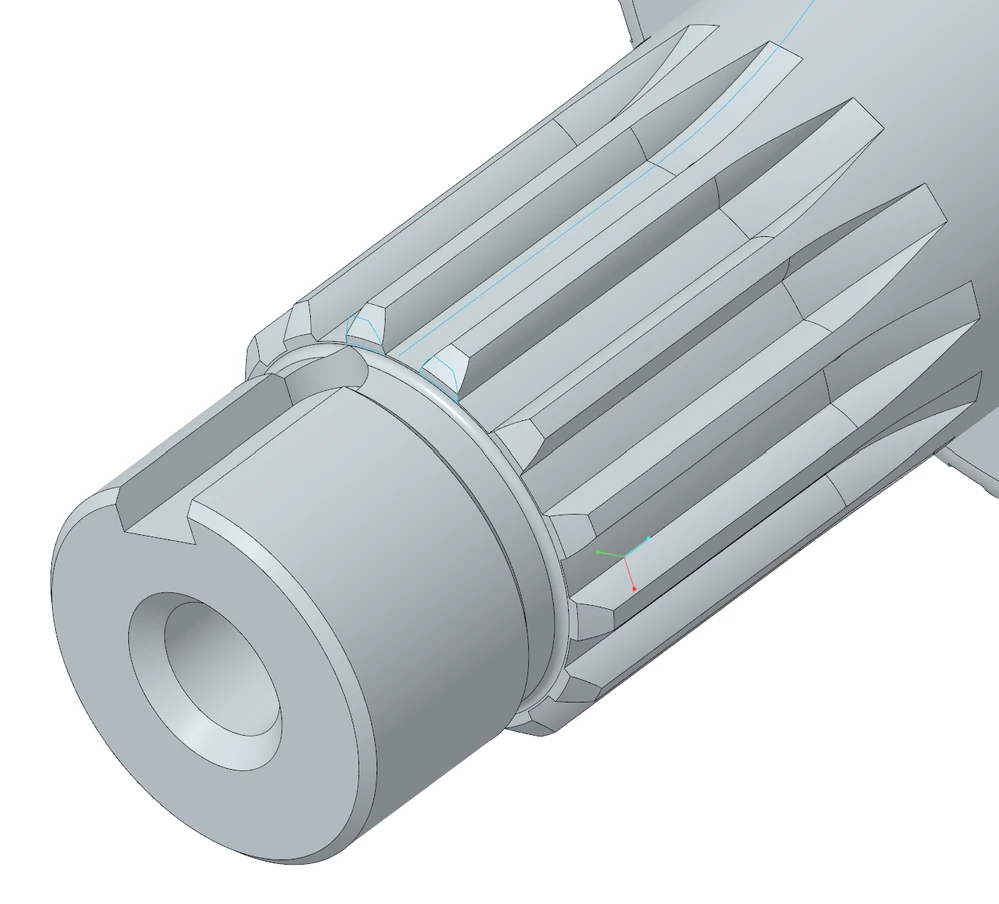

Now, drawing shaft
the sketch is make with the same involute equation
but i use a sweep feature ( not extrusion feature)
because in real life, when i machining the shaft i have the cutting tool geometry

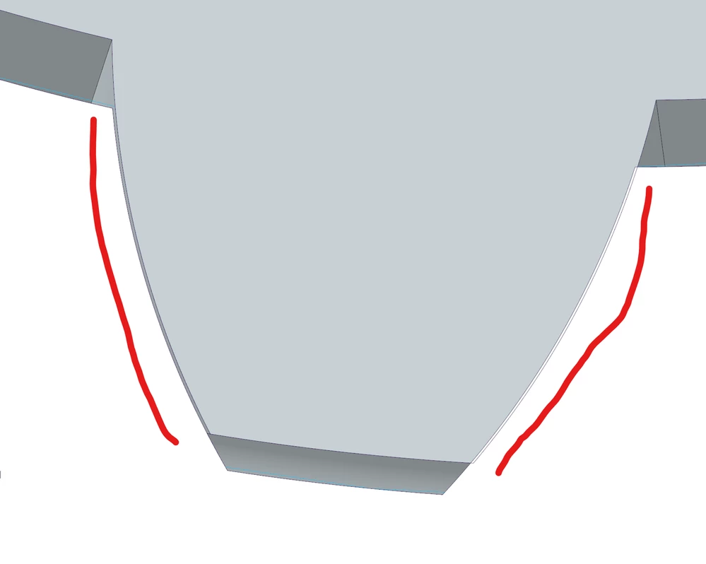

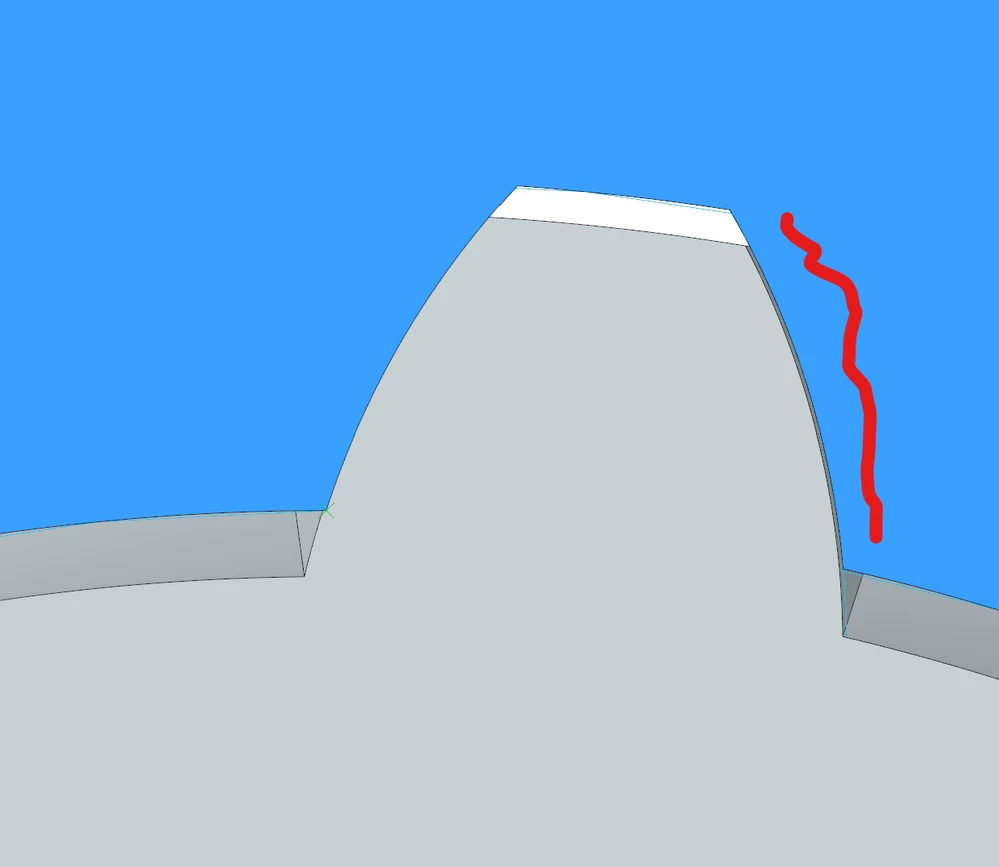

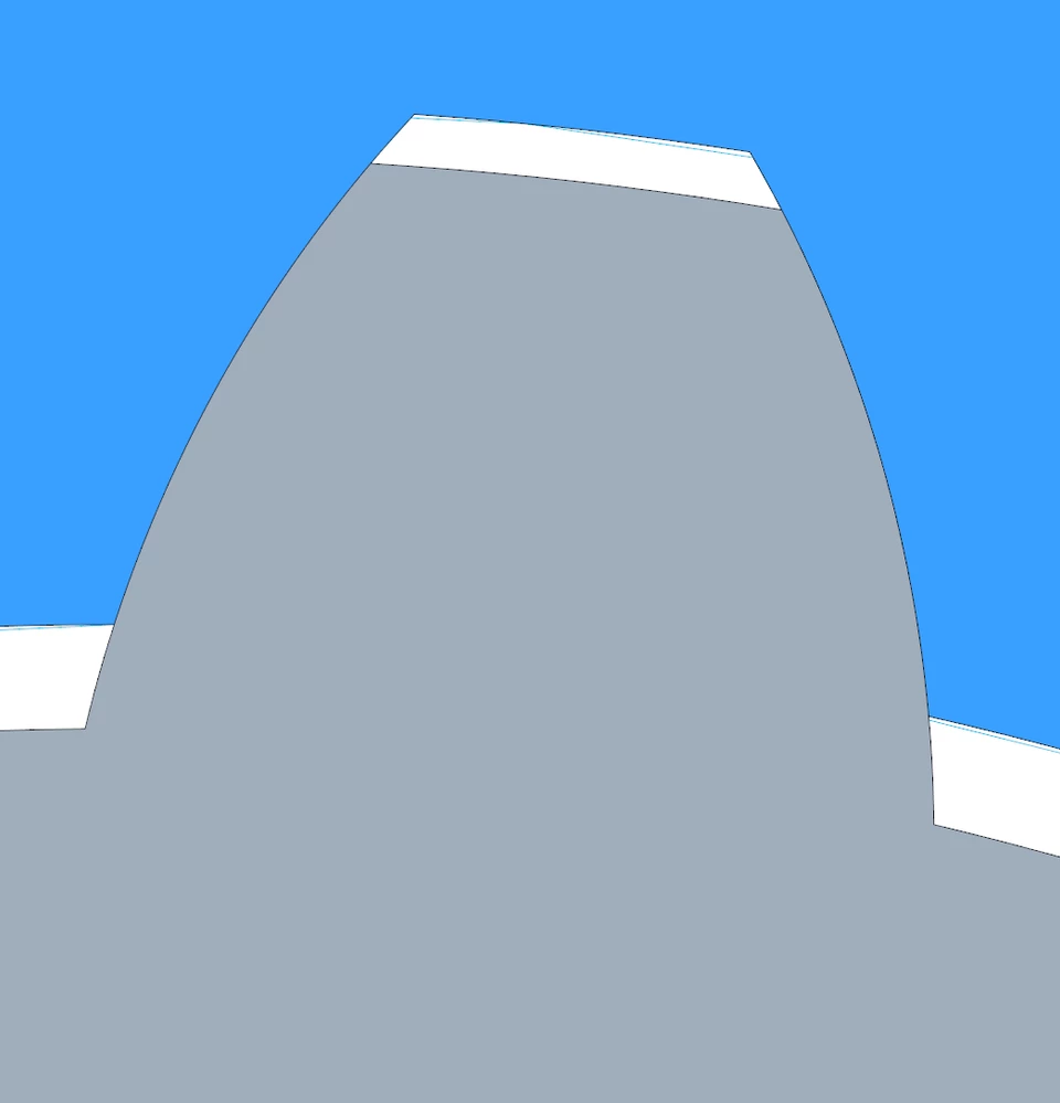

After this, i assembly this part, and now:
i have offset between hub and shaft😱
it is possible th sweep feature make it ?
sweep feature option perhaps
i use Normal To Trajectory
i don't uderstand this options,
Normal To Projection
Constant Normal Direction
thanks

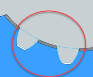

StephenW
Dec 8, 2022 3:15 PM UTC
If you look at this part of the shaft, does your sketch exactly match the sweep  cut made?
