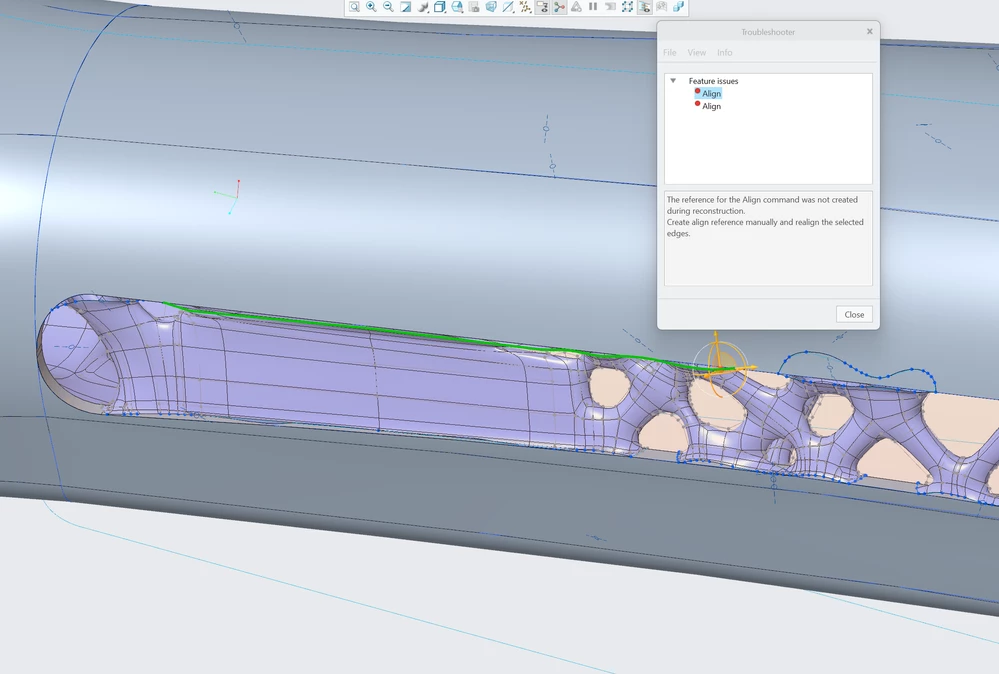

I have used generative design in order to make lighter my design. But when I generated results, the reconstructed shapes had an issue, the Align command for two different curves was not created. I have tried to create manually alignment, but it is not accept it.

Have you tried increasing the part accuracy?
