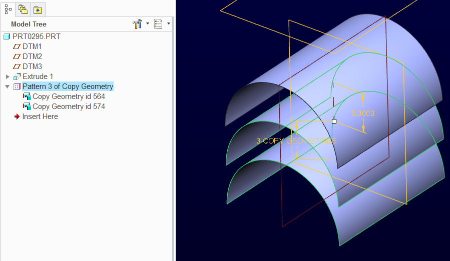

I've observed a difference in geometry pattern & feature pattern.
I've just migrated to Creo Prametric 2.0 from Pro E 3.0
While pattering a geometry - under the numbers box.
If I write the no. = 2, well it creates 2 geometry
If I write the no. =3, it creates 4 geometry
I want to understand the logic behind it.
Where as in the feature pattern-
If I write the no. = 2, well it creates 2 features
If I write the no. =3, it creates 3 features.
please Help!
Thanks!

That definitely looks like a bug. I had the same results using your method in the powerpoint; I'm on Creo 2.0 M70. I tried the following similar methods:
  • Method 1: Geom pattern the solid surfaces = bug
  • Method 2: Copy of the surfaces then geom pattern the copy = OK
  • Method 3: Select one surface then geom pattern, then use the references dialog to select more surfaces = OK
  • Method 4: Use ALT+CTL and select all surfaces individually then geom pattern = OK

If you turn off the solidify option on the Options tab on the Geometry References it copies the solid surfaces as you were expecting it to.
