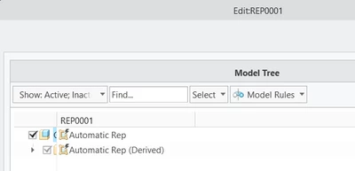

Hello, I want to create Geometry simplified representation by Creo 10 (I have very huge assembly and I do not need info about nested features/geometry from subassemblies).
In the past in old Creo, was possible to create Geometry simplified representation.
In Creo 10 I have found option: simprep_default_model_status graphics
but is not working. When I create new rep, system always create only Automatic representation

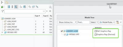

Hi I have set the option in my environement :
and it works fine by me :
here is a comprehensive article about the option : https://www.ptc.com/en/support/article/CS62681
