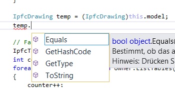

June 21, 2016
Hi Parthiban,
thank you for the great code. You gave me the hint I needed.
Unfortunately I´m using C# and the interface is not exactly the same as in VB.
E.g. if I make a IpfcDrawing out of the model, there is no ListTables-Operation. So there are a lot of obstacles to overcome 😃
FYI: I needed to use IpfcTableOwner to catch the tables. See below (C#) code for getting the cell-informations of the tables.

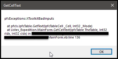

December 19, 2019
old thread revival ...
trying to do the same thing but using VB API.
I get into a problem I cannot figure out, using this code:
	Private Function GetCellText(TheTable As IpfcTable, rIdx As Integer, cIdx As Integer) As String
		Try
			Debug.Print("Number of lines in table: " & TheTable.GetRowCount)
			Debug.Print("Number of columns in table: " & TheTable.GetColumnCount)
			Dim MyCell As IpfcTableCell = (New CCpfcTableCell).Create(rIdx, cIdx)
			Dim MyText As Cstringseq = TheTable.GetText(MyCell, 0)
			Return MyText(0).ToString
		Catch ex As Exception
			MsgBox(ex.Message & vbNewLine & vbNewLine & ex.StackTrace,, GetCurrentMethod().Name)
			Return Nothing
		End Try
	End Function
I get an exception from xToolkit at the line "Dim MyText As Cstringseq = TheTable.GetText(MyCell, 0)" but I can't find what I am doing wrong.
Any idea?
