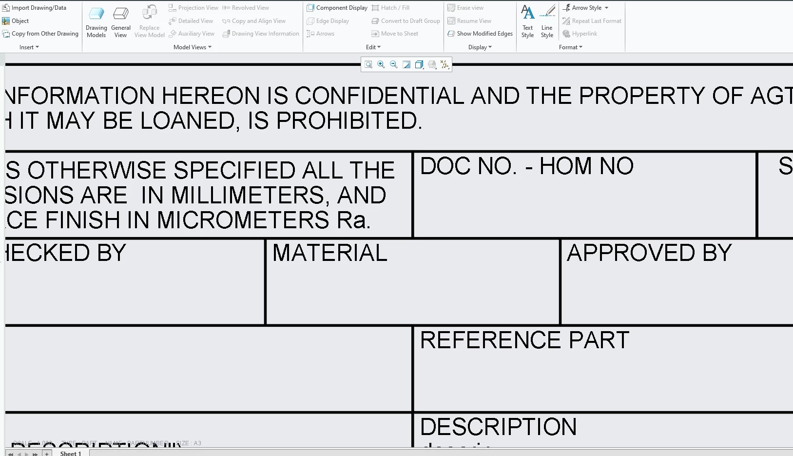

Does anyone know how I can get material to show up in a title block? I'd like to see the material assigned to a part in the drawing.
i couldn't find the parameter for material.
Any assistance is greatly appreciated!
kdirth
kdirthAnswer
In the table cell of the format enter &PTC_REPORTED_MATERIAL or place a not with the same text over the cell.
