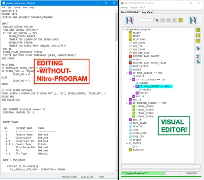

If you have ever struggled with seemingly never ending edit-import-fix-import-fix-import cycle of creating or editing Pro/PROGRAMs for Creo Parametric Parts or Assemblies... -OR- nearly screamed while trying to edit a Pro/PROGRAM that someone else created....
Then Nitro-PROGRAM is something you should download immediately and use!
Nitro-PROGRAM eliminates the pains and frustrations of the "text editor" and transforms the creating, editing and testing of Pro/PROGRAMs into a visual, drag-and-drop, editing love-fest by comparison.  😉
Nitro-PROGRAM saves time, reduces frustration, improves accuracy and enables you to think about the most important elements of Creo Parametric Automation -- data-flow and regeneration!

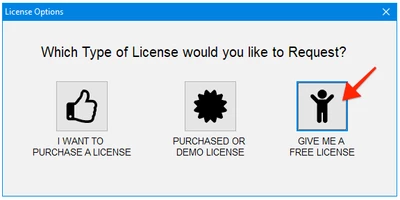

Simply Download, Unzip, Run.... and request a FREE License... NO REGISTRATION REQUIRED!

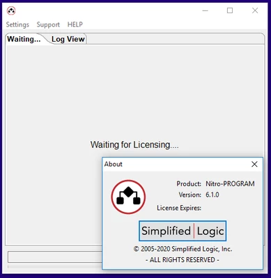

I would like to try Nitro-PROGRAM, but I get the "Waiting for Licensing..." message. I don't get the option to choose for the "Free License".
I am running the 6.1.0 version:
Edit: I might have installed a previous version of Nitro-PROGRAM in the past...maybe something was left in my registry that makes Nitro-PROGRAM looking for a license?
18-Opal
July 30, 2020
Usually that is a firewall related thing on your computer or company network.
Licenses are obtained over HTTP -- so that should not be the issue.
You might try running the application as Administrator to see if that makes a difference.  If you can't check the local firewall settings to enable the application to run, also these ports locally should be OPEN in the computer's local firewall:

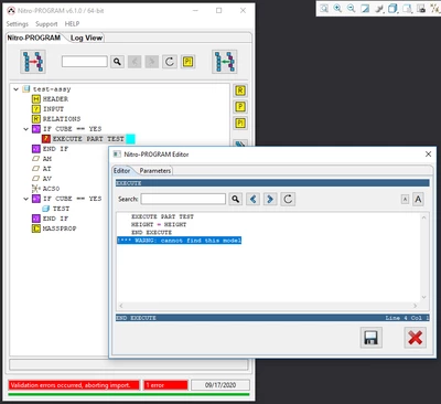

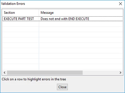

I am testing Nitro-PROGRAM, and I am running into this situation:
I have an assembly where initially a component is suppressed. So when I open the assembly, that component is not loaded into session.
Creo will give a warning in Pro/PROGRAM that it can't find that component.
IF CUBE == YES
   EXECUTE PART TEST
   HEIGHT = HEIGHT
   END EXECUTE
!*** WARNG: cannot find this model
END IF
But Nitro-PROGRAM will give a Validation Error, because the EXECUTE statement "Does not end with END EXECUTE"
Well...it does end with END EXECUTE, but Nitro-PROGRAM also "includes" the warning message, thus throwing the Validation Error.
Nitro-PROGRAM should (have an option to) ignore the warning message of Creo.
18-Opal
August 7, 2020
Ok - Just for anyone that finds this post....
The issue has been resolved and is available for download at:
Dave

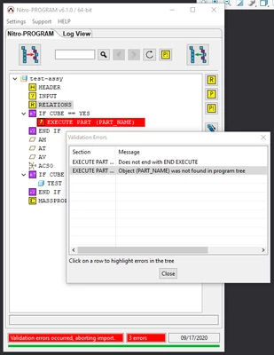

I have another situation where Nitro-PROGRAM throws a Validation Error:
We use the EXECUTE statement with a variable name. That name is calculated in the Relations of the assembly.
But when I try to import, Nitro-PROGRAM says that "Object (PART_NAME) was not found in program tree":
PART_NAME is in the Relations section of the PRO/PROGRAM, but Nitro-PROGRAM cant find it somehow.
I have attached my test assembly so you can take a look 🙂
18-Opal
August 3, 2020
The "!*** WARNG: cannot find this model" is actually in the Pro/PROGRAM....  a PTC Error.  (edit it conventionally - you should see it there if you open up the test-assy.asm as the only thing insession and edit the Pro/PROGRAM).
I will check on the impact of that PTC error in the parsing of the Pro/PROGRAM within Nitro-PROGRAM... and you are right the variable name in the EXECUTE is obviously not parsing as valid... To be honest... I never thought of that...  pretty clever! 😎

@DavidBigelow wrote:
The "!*** WARNG: cannot find this model" is actually in the Pro/PROGRAM....  a PTC Error.  (edit it conventionally - you should see it there if you open up the test-assy.asm as the only thing in session and edit the Pro/PROGRAM).
Yes, it's a Creo warning that you will get if you open the PRO/PROGRAM when a component is not in session. But Creo accepts that warning if you make changes to PRO/PROGRAM.
Nitro-PROGRAM on the other hand throws an error, and refuses to import any changes to PRO/PROGRAM.
We are using that technique on a few components, works like a charm 😎
