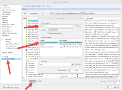

In the cofiguration editor, use FIND
Then type a keyword, I used texture, since I know there aren't that many options using texture.
Select the one you want, set the value and then Add/Change. Make sure you save the config when prompted.

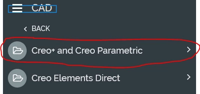

You are in the wrong forum.
PTC has two CAD systems:    Creo+ and Creo Parametric    and     Creo Elements Direct.
Which makes it confusing.
More, for Creo Elements Direct:
- The 3D software name is Modeling, and
- The 2D software name is Drafting.
For Creo+ and Creo Parametric, use only this tab:
You should move your post to this community to have a better chance to get an answer.
To move your post, click on the three vertical dots on your initial post and click on "Notify Moderator".

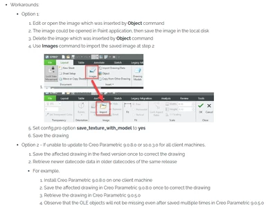

I'm not sure if this is the same problem as https://support.ptc.com/appserver/cs/view/spr.jsp?n=14809409&_gl=1*1i5jb0o*_gcl_au*MjczMTE2NDA5LjE3MzU4MTU0NjAuNzY3NTczNjUuMTczODI3Mjc2My4xNzM4MjcyNzY5*_ga*MjAzNzY0MjE0My4xNzI2NDk3MzYx*_ga_7NMP2MSYPM*MTczODMyMTk0Ni4yMDQuMS4xNzM4MzIyMjM5LjguMC4w*_ga_CBN5QVB9VJ*MTczODMyMjE1OS4xMTAuMS4xNzM4MzIyMTg3LjAuMC4w
This shows to have been fixed in Creo 9.0.8.0 but you have to save at least once in that version.
It also shows some work-arounds (if it is the same issue)

I believe you need to set config save_texture_with_model to yes.
This will save all images in models and drawings in the file.

I've search "save_texture_with_model" parameter in both "Config.pro" and "config.sup" with no success, do you guys know where can I find it?
