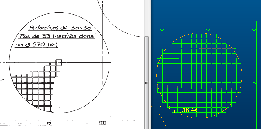

I'm trying to model a grille as shown on the left side of the added picture, but Creo 2.0 gives me the one on the right side.
Any ideas on how to make this happen?
This is a sheet metal part, because the plate is curved. If it were just a solid a would add an extra extrude to fill the excess, but that doesn't work in sheet metal.
Robbie.

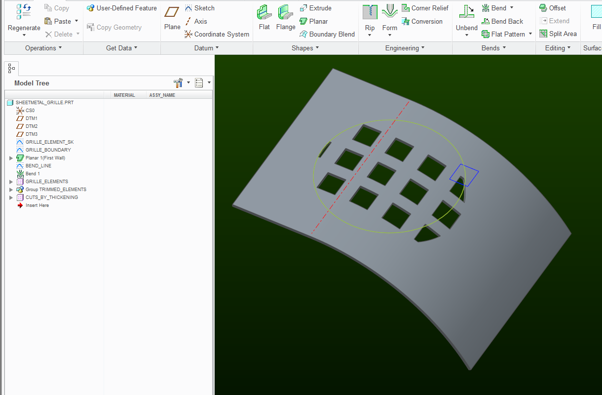

You can make cuts to a sheet-metal part using thickened surface elements:
Examine the attached part file (Creo 2.0 model).  In it, I cut a grille into a curved piece of sheet-metal.
This is how I went about it:
1) create a sketch GRILLE_ELEMENT_SK that defines the grille opening
2) create a sketch GRILLE_BOUNDARY that defines the boundary
3) use the fill command to turn GRILLE_ELEMENT_SK into a surface patch
4) pattern the surface patch to form some kind of a grid of patches
5) trim the patches at the boundary using the sketched circle curve.  Obviously, with more holes this becomes a very tedious task.
So, I recommend this mapkey that executes the copy -> paste-special -> advanced ref. configuration sequence, using the currently selected feature as the template:
mapkey cv @MAPKEY_NAMECopies currently selected feature;\
@MAPKEY_LABELCopy and Paste Special (cv);\
~ Command `ProCmdEditCopy` ;~ Command `ProCmdEditPasteSpecial`
~ Activate `paste_special` `makecopyiesPB` 0;\
~ Activate `paste_special` `pastebyrefPB` 1;\
~ Activate `paste_special` `okPB`;
(in this manner, you just have to pick a trimmed patch, type cv, then select the next patch to be trimmed and OK!
6) Anyway, after all that, select the 1st patch in the pattern (important!) and thicken it - this should make a single-cut in your sheet-metal.  Make sure you cut in the right direction.  Also be aware of the tool's options that result in different ways the cut will be made.
7) Select the resulting thicken feature in the model-tree, right-click and select "Pattern".  The reference pattern should be activated and the whole grille will be produced.  It's a bit baffling how it remembers that some of these patches were trimmed, but it does...
Caveats: if anything in your design changes in a significant way, you will probably need to delete the last pattern and go through steps 5-7 again.
Also, you might want to do this all this grille-cutting before doing any bending / forming...
