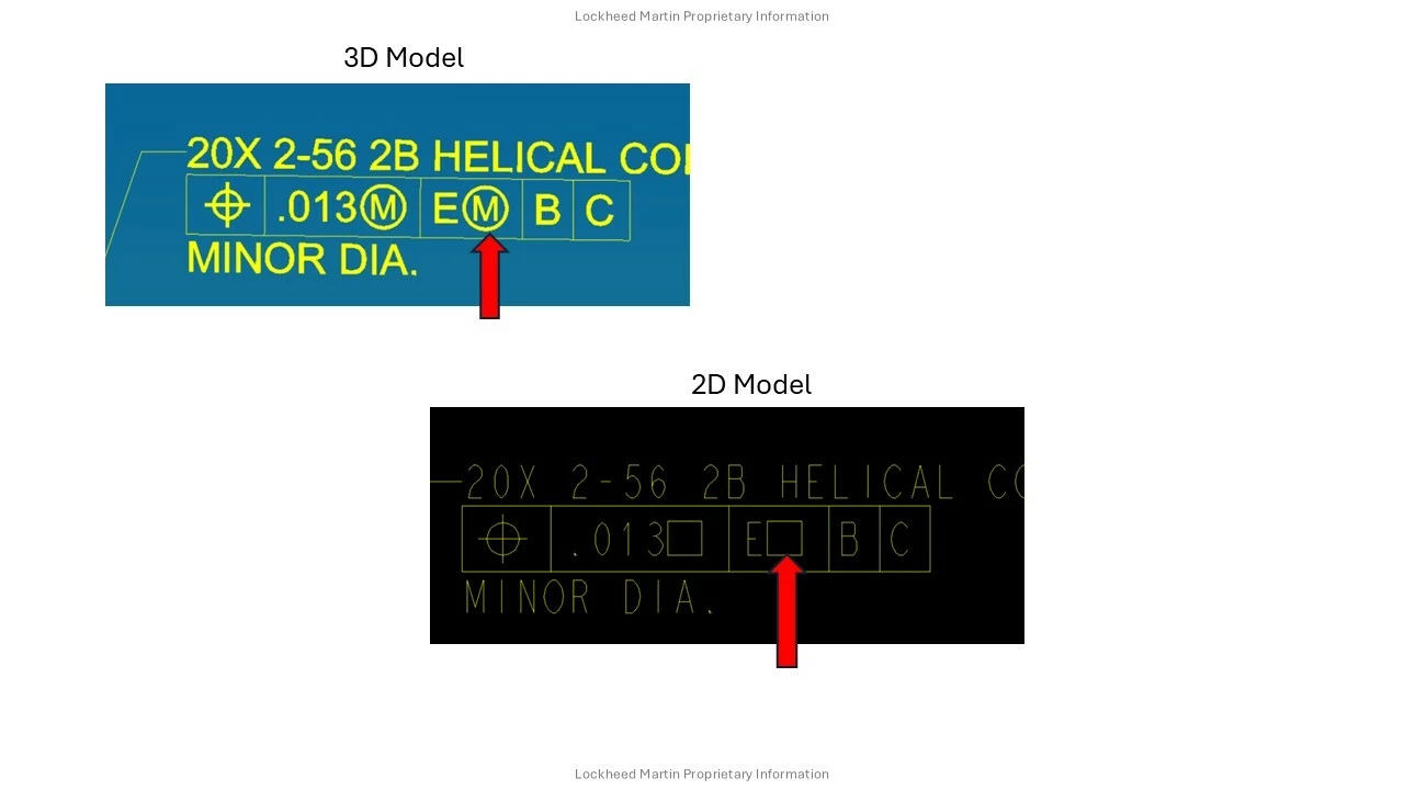

Hello, I’m currently using the GD&T Advisor under the Applications Tab within my 3D model. For unknown reasons, when I display the GTOLs in my drawing, the modifier symbols don’t show up. They just display as a blank box. Please see the attached picture. Has anyone ever ran into this before? Not sure if it’s a config setting or something else.

You may need to change the font in your drawing.
Look up option symbol font in the drawing and make sure it matches the symbol font in your model
jchance12-AmethystAnswer
Check the value of the configuration option symbol_font both in config.pro and config.dtl. For me it is ISO. If your organization follows ASME, set it to ASME.

Thank you everyone! I found a resolution. It was indeed a font issue as everyone had mentioned. It was a matter of using the correct one. 😊
