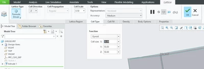

Hello i want to create a gyroid lattice body in creo educational however the representation option is grayed out (see picture). This needs to be changed to the nessecary "Full geometry" for a real body to generate. Does anyone know if this is simply a limitation by creo put on the educational version? Or is there a fix?
/ Thanks!
activate Cell Type tab in Lattice dashboard.

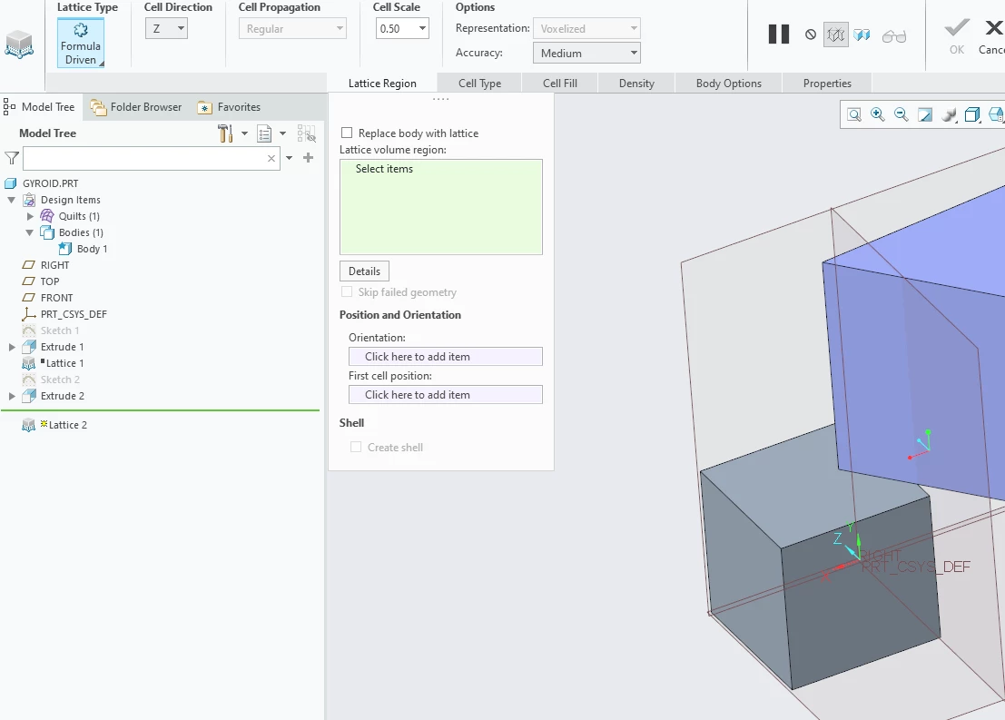

Hi ,
Formula driven lattice (FDL)  support only Voxelized representation hence it is grayed out.
