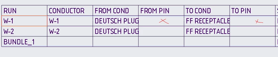

Hello! I’m trying to make a simple cable harness 2 wires going from connector 1 to connector 2.

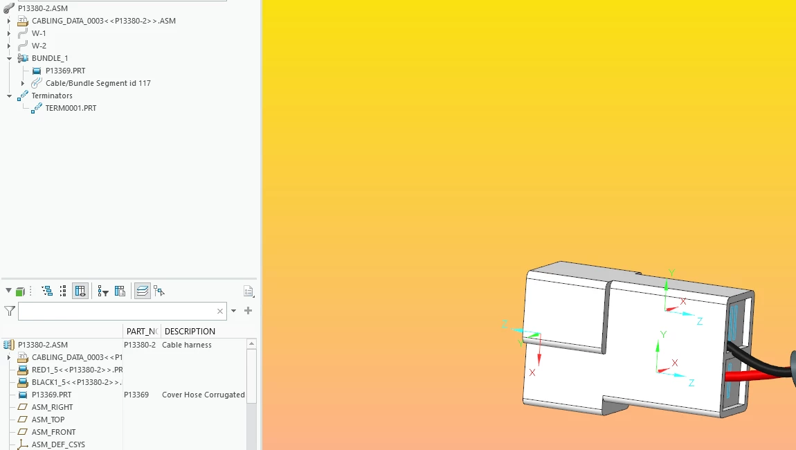

There are 2 coordinate systems in each connector that I have made.
On my drawing i’m trying to use repeat regions to display which port in the connector each wire should connect to. However no pin no. gets displayed, it doesn’t matter if I select the repeat region to be driven by the assembly or the connector part.
I’m using &harn.run.cond.from.pin.entry_port and have tried a bunch of others but it remains blank regardless.

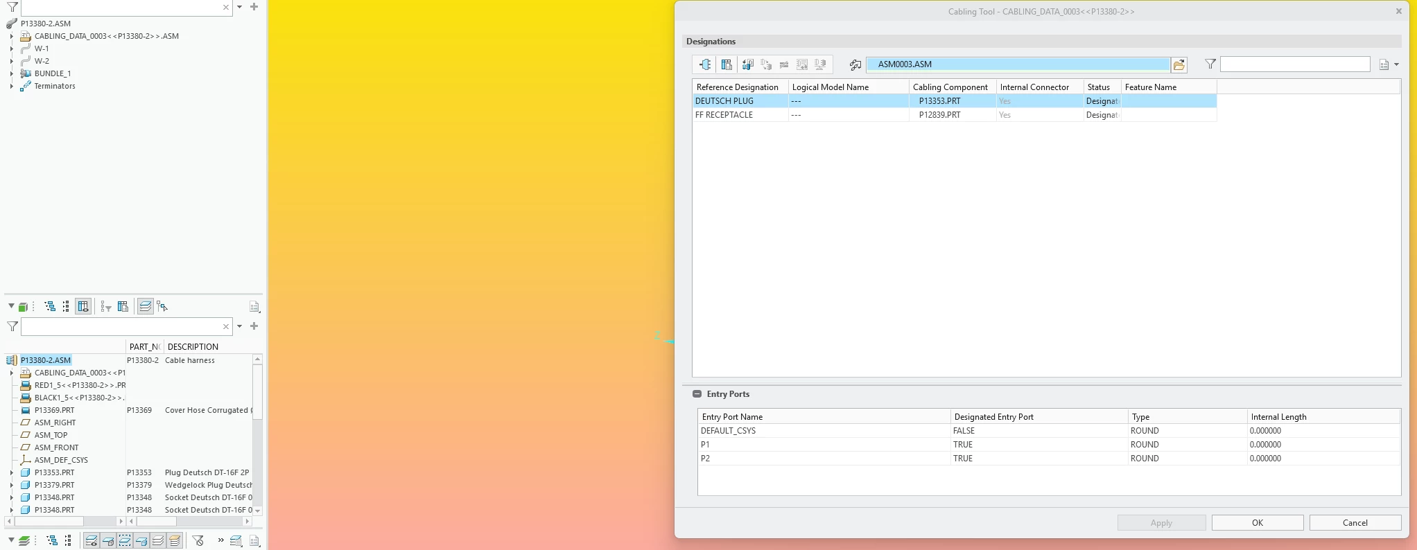

I have tried creating Terminators inside the assembly but am unable to do anything besides create it? No editing or anything seems to be possible. I read some other posts where they supposedly add cabling parameters somehow? I don’t see how to do it.
Any help to display pins on the drawing would be greatly appreciated!

Hello Mahesh,
What is this flat harness file you mention? Do you mean the cabling data file?

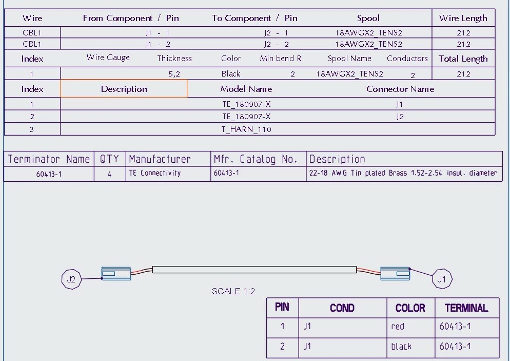

I tried using the harness mfg application but it autogenerates tabls without any relations so I can’t really work with that effectively. Current result of that looks like this:
Best Regards, Alex

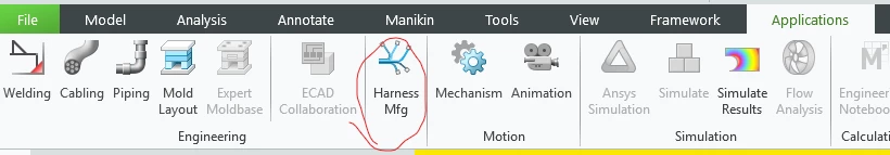

There was also no need to do the flat harness files to see the pin numbers. The cable part file has all the connection info that can be used on the table. If you need the flat representation then you select the File->New->Manufacturing->Harness (if it still exists). We don't use the Harness Mfg button since it is a separate license that costs money. You can achieve similar results with the Manufacturing-harness option, although it is harder to use.
Old Creo also allowed editing terminators via the "Logical Data -> Terminators -> Edit"
We usually had the parameters "Description", "Manufacturer", "Catalog" on our terminators. Since the new terminator is a part then perhaps you can just edit the part parameters and add whatever info you need for the part.

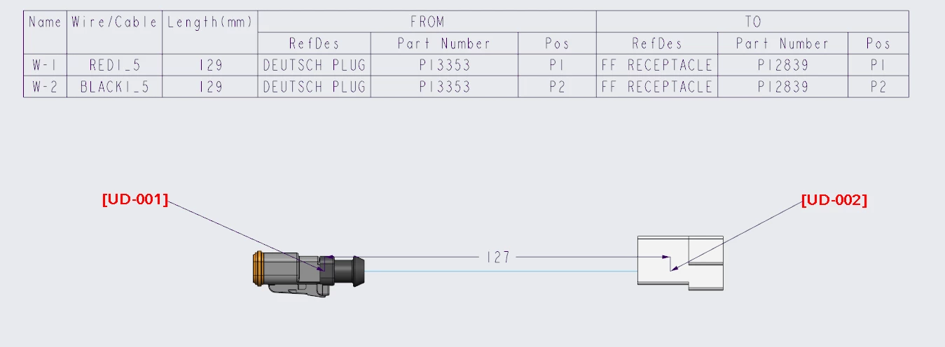

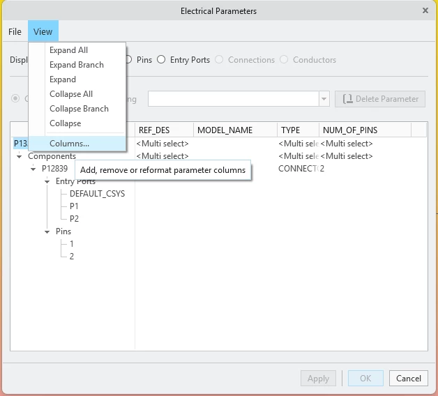

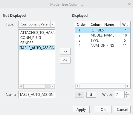

Yes I’m using Creo 12 and harness assembly to make my cable harness. I found the repeat region reference names but the problem I had was there were no pins designated for my connectors. I did however manage to find how to designate them now manually:
Then
By adding the columns. I hadn’t figured out how to add these to the electrical parameter columns earlier. Now I just need to figure out how to make the program automatically detect coordinate systems in my connectors so that they get auto assigned to pin numbers. Also I will try the “manual” harness manufacturing method for flat drawings. About the terminator I thought it might be used for pins assignment but I was mistaken.

In Creo, Terminators define how a conductor is terminated at a connector. Each connector pin can have its own TERM_NAME parameter:
<PARAMETER name="TERM_NAME" value="60413-1" />
We primarily use terminators to specify which crimp terminal the subcontractor should use for each connector pin. Different pins within the same connector can use different crimp terminals. For example, if some pins use thicker wires than others, they may require a different crimp part.
