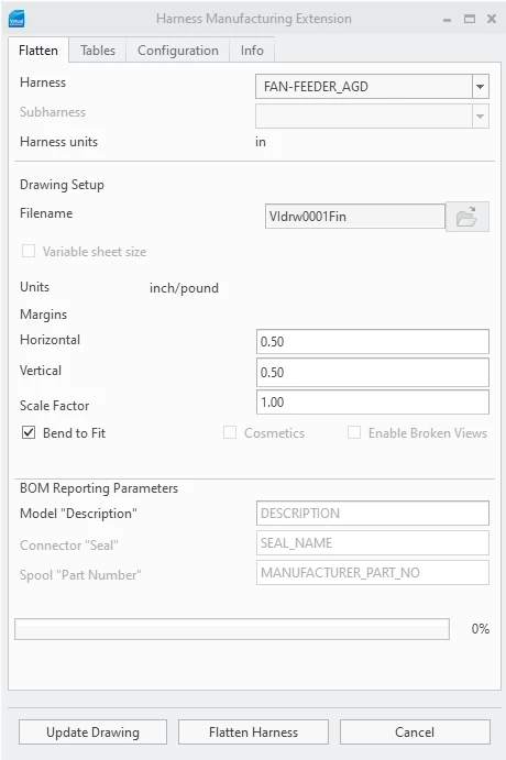

I'd like to use a custom template when creating a harness mfg drawing (as shown in the help link below, step 4), however the browse to file selection is greyed out (as shown in the attached screenshot). Does anyone know how to allow this selection?
To Generate a Flattened Harness Manufacturing Drawing (ptc.com)
I'm using Creo parametric 8.0.7.0.
Any help is greatly appreciated!

My guess is that you are using the HMX lite
You need the HMX standard license to be able to customize the drawing template

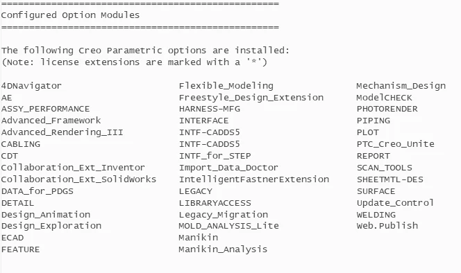

Apr 26, 2024 7:26 PM UTC
Thank you, I didn't realize there were levels of licenses for this module. I can't seem to find the specific license I have, but I will keep digging. I've only found the attached screenshot showing the module is installed. Thanks again!

Apr 26, 2024 7:56 PM UTC
Glad to help, this is what the HMX advanced license looks like on the License options in my Creo 8 session:
