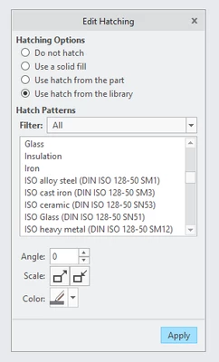

Hi all,
I'm wondering where is the default hatches library location ?
I've search all *.xch and all *.pat, without success.
I also know how to create my own library, but I would prefer to have all files in a single location.
Thanks for your help ! 😉

Under the Creo loadpoint directory, e:/ptc/creo4m080/creo4.0/m080/commonfiles/text/crosshatch, there are some *.pat files.

Pier_8wd1-VisitorAuthor
August 16, 2021
Great !! Ah you're right ! Thanks
So one *.pat contain several *.xch ...
Oh I still have things to discover with Creo...
August 16, 2021
  • Creo Parametric 3.0 (and older versions) installations contain .xch files, only
  • Creo Parametric 4.0 (and newer versions) installations contain .pat files, only
August 17, 2021
Thanks Martin for this precision. I will try to progress on this way.
